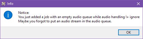

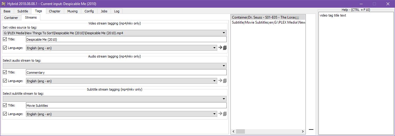

So I converted the first movie (Despicable Me) from .mp4 to .mkv, no big deal, everything worked great, and saved part 1 of the attached log file in that same folder.  Then, without closing the program, I loaded The Lorax into Hybrid.  It did not seem to reanalyze it, it did not change the output folder, or name to the new one, as a new file would normally do.  I added the appropriate subtitles and tags, but when I went to the tag screen, under streams, it only had the previous video stream (Despicable Me), and no audio tracks were listed.  Since I had it set to passthrough, there was no way to set the audio tags, without changing it to custom, which kind of defeats the purpose of dragging and dropping a file in there, if it is not analyzing it.  Then, just to test, I tried adding a job, thought maybe it would passthrough the Lorax audio, but then the error message popped up, so I tried to add it manually, after manually changing the output file location, folder, and name, then Hybrid crashed.  I attached both logs from both location.  Maybe you can tell me if something is set incorrectly?
