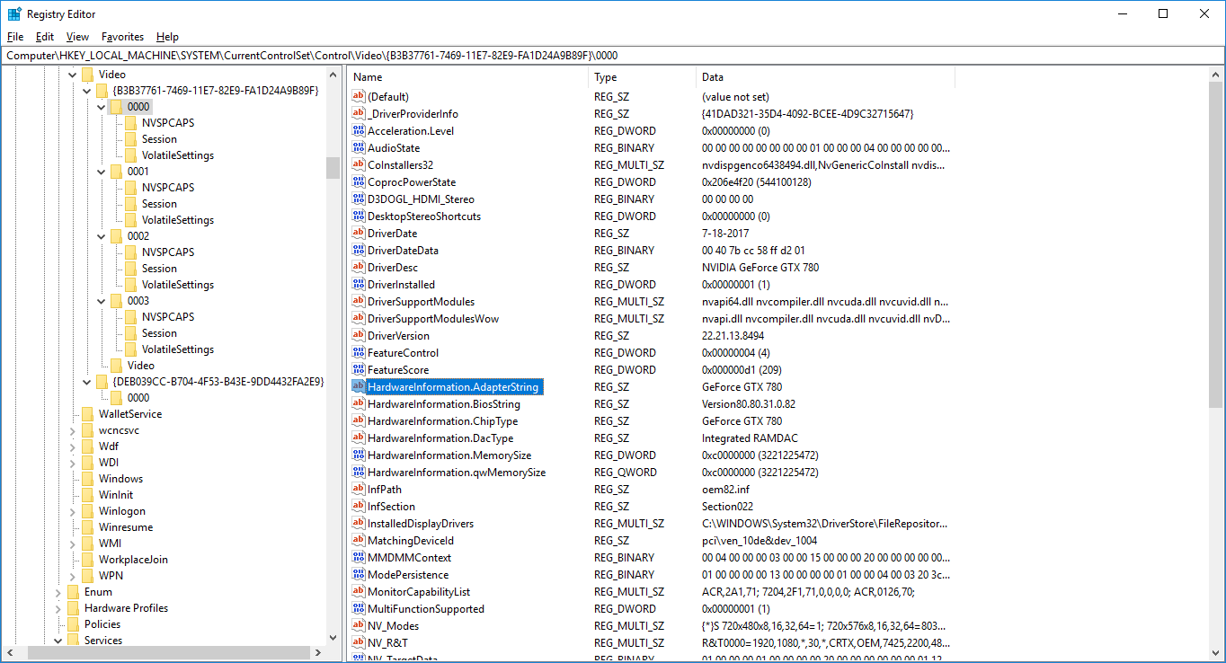

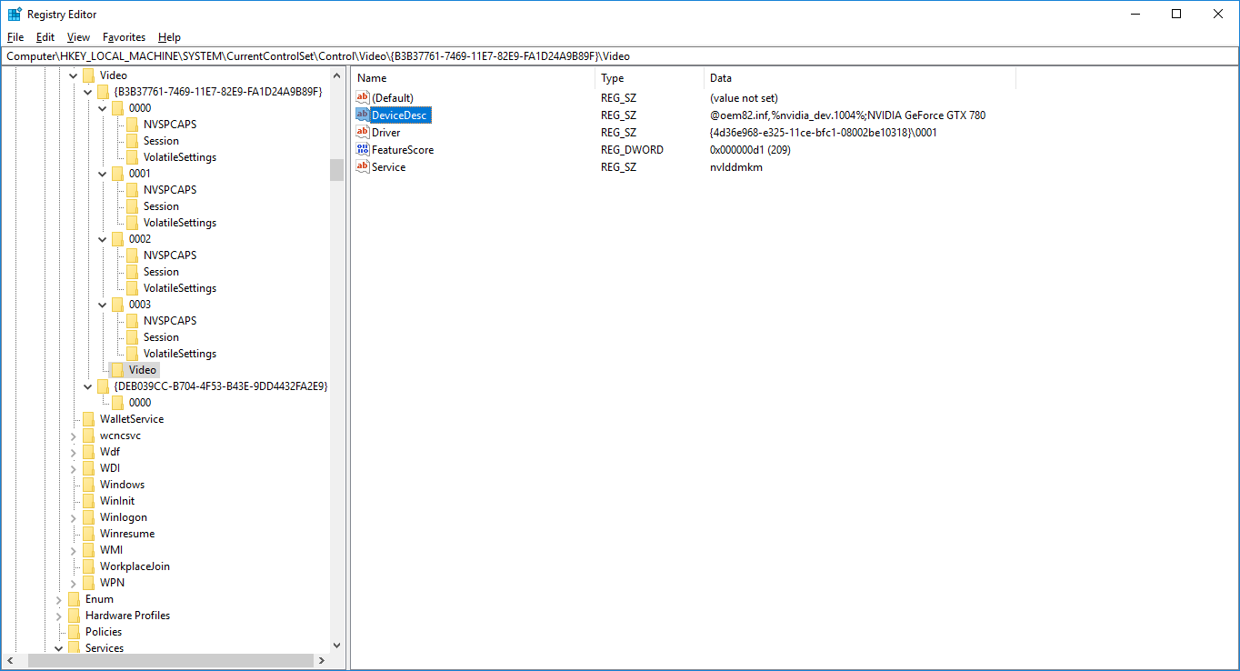

Here's what's under that Video key:
[Image: 4b9mTUf.png]
Of note, the second Video key (highlighted) has a value named DeviceDesc with the data:
@oem66.inf,%nvidia_dev.1004%;NVIDIA GeForce GTX 780
There are no values directly under HKLM\SYSTEM\CurrentControlSet\Control\Video.
I'm running Windows Insider build 16241, if that helps.

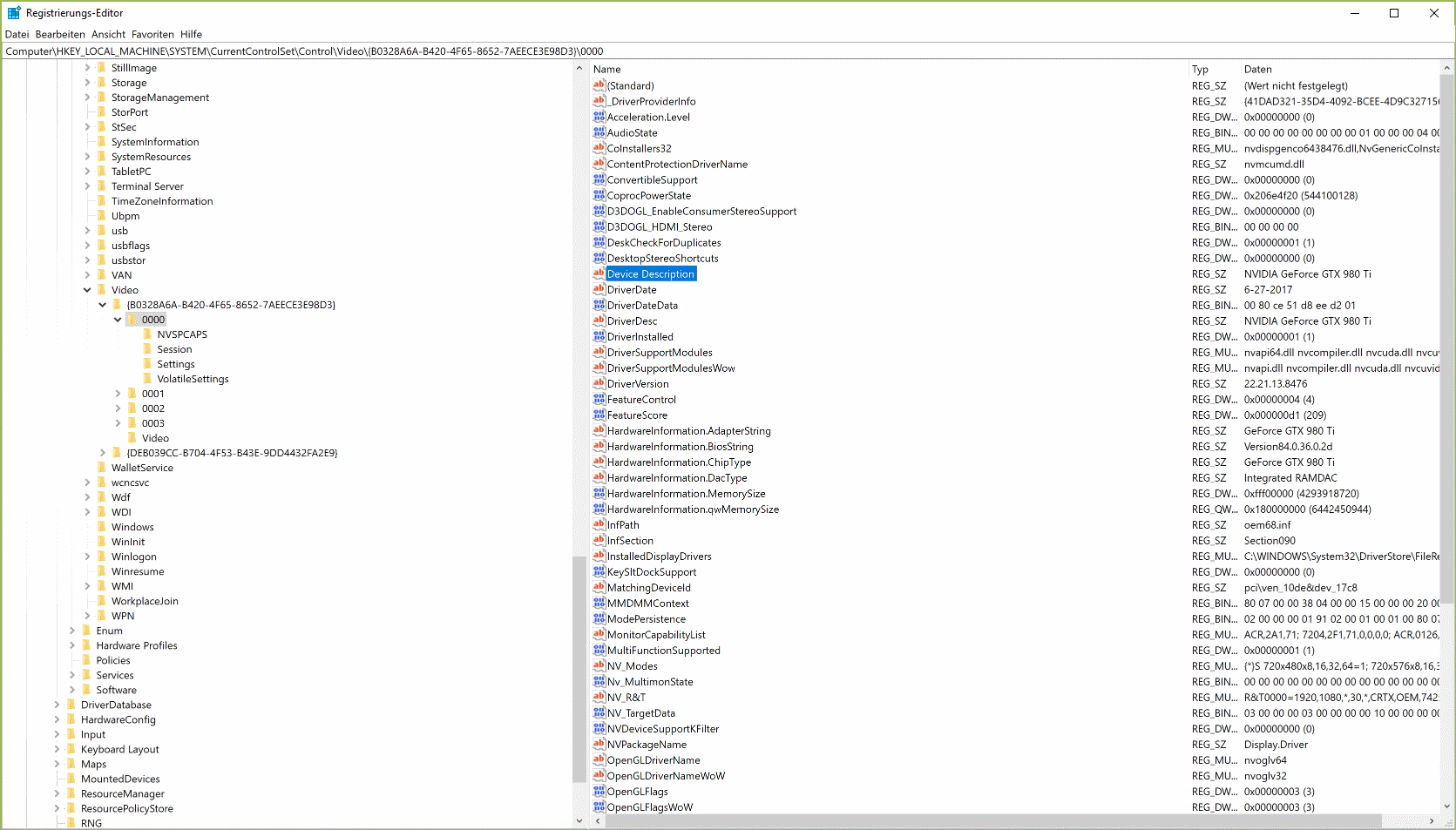

I looked at those keys and found several with DeviceDesc, but none with DeviceDescription (or were you just generalizing?)
If it helps I'm happy to export my Reg entries
No, I'm not generalizing. Hybrid looks for 'Device Description' entries below 'HKEY_LOCAL_MACHINE\SYSTEM\CurrentControlSet\Control\Video'.
An export of the 'HKEY_LOCAL_MACHINE\SYSTEM\CurrentControlSet\Control\Video' might be worth a look.
