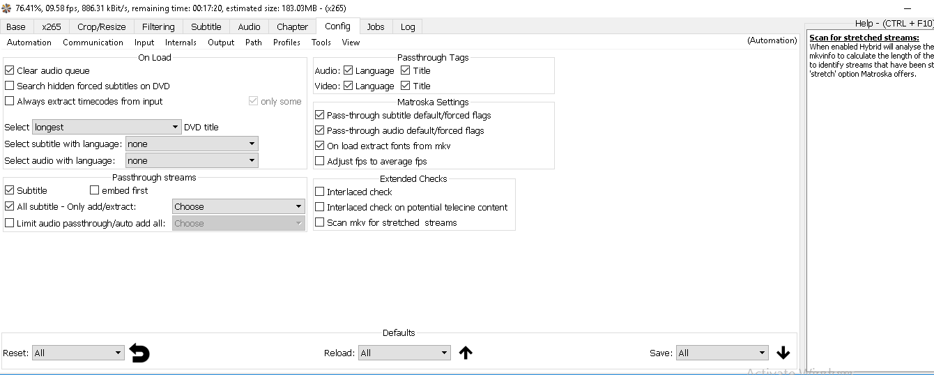

Hybrid should passthrough the 'default' and 'forced' track flags automatically assuming:
a. your source is mkv
b. your target is mkv
(the file names should reflect this with a '_default' or '_forced' flag)
Note that mkv is the only container which is supported by Hybrid that allows to set a default/forced track and that even with mkv whether the player follows the advice to set a track as default track depends on the player.
To my knowledge none of the containers Hybrid supports as output have a forced/default track as DVD/Blu-ray do.

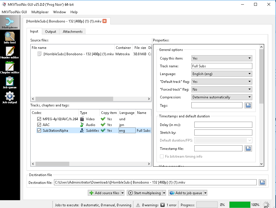

The subtitle in the source is set to default(yes). Plus the track has a name. After encoding none of these get passed through. The source is MKV, target is also MKV. I've attached my settings in automation.
Source
Thumbnail(s)

What I meant was in the bonobono image(the source) the subtitle track is set to default meaning the subtitle will be played automatically with the video and audio when the player is started. The track also has a name "Full Subs". In the bonobono2 image after encoding its set to "Determine automatically) meaning its up to the player to determine whether or not it will be on during playback. Its always off in this case, you have to switch on the subs manually during playback. Also the track name "Full Subs" wasn't passed through to the output. Usually some sources come with more than one subtitle and each track has a name/description attached there

Posts: 13.400
Threads: 78
Quote: What I meant was in the bonobono image(the source) the subtitle track is set to default meaning the subtitle will be played automatically with the video and audio when the player is started.
Quote: For the "default track" flag: The special consideration is that mkvmerge will automatically set this flag to "yes" for exactly one track of each track type (audio, video, subtitles). You can only prevent this by explicitly setting the "default track" flag to "no" manually for all tracks of a kind (e.g. for all subtitle tracks).
The "default track" flag tells the player that this track should be played unless the user overrides that decision somehow. You usually mark the original audio track with "default track" and leave it off for the rest of them, e.g. for the director's commentary or some translations you don't want [(e.g. The Lord of the Rings, mark "English" as "default track" but not "German" and "Director's comments (English)].
As a lot of users don't want subtitles shown by default, they tell mkvmerge not to set the "default track" flag for any subtitle track.
Now on to the "forced display" flag, in short "forced". If this is set to "on", this track must be played/shown no matter what the user selected for his preferences or what the player would normally chose to show/play. This is used seldom, e.g. only for a subtitle track that only contains the English translation whenever Legolas is talking Elbish.
"Forced" has nothing to do with "default track". If "forced" is set, the player must play that track no matter what "default track" is set to. In fact, normally a track that has "forced" set does not have "default track" set, though it is neither invalid nor undefined behavior.
source:
https://gitlab.com/mbunkus/mkvtoolnix/wi...in-the-GUI
