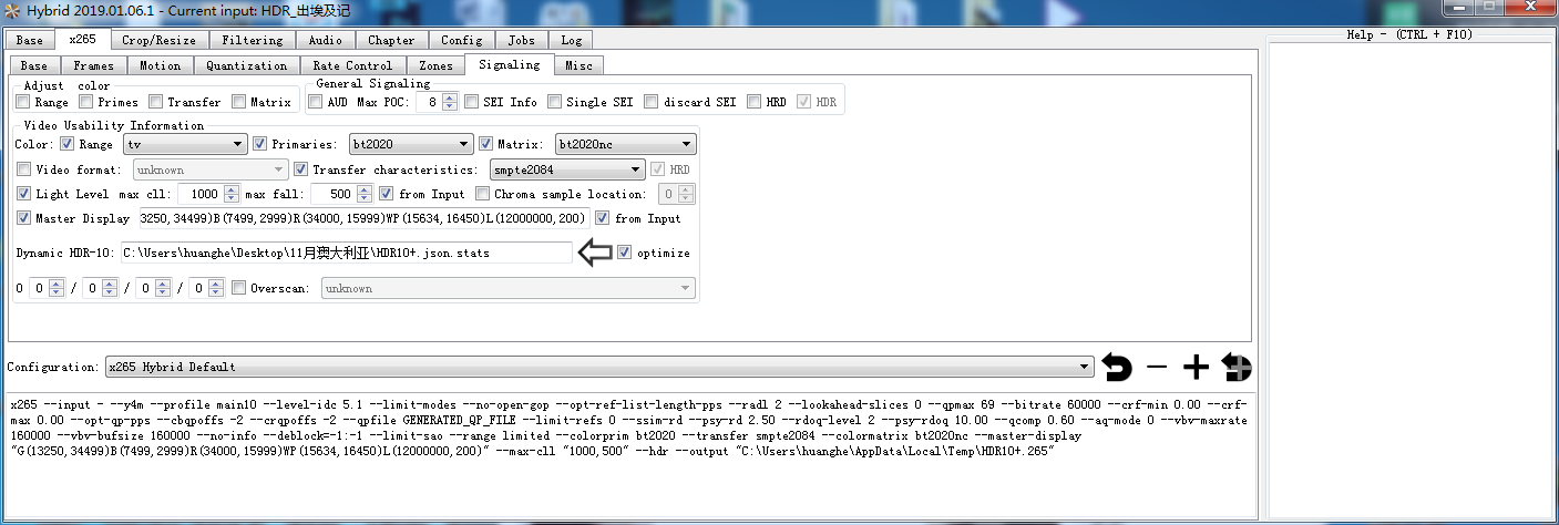

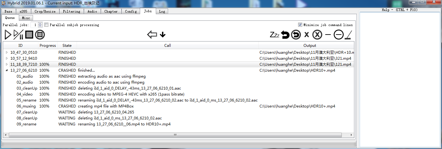

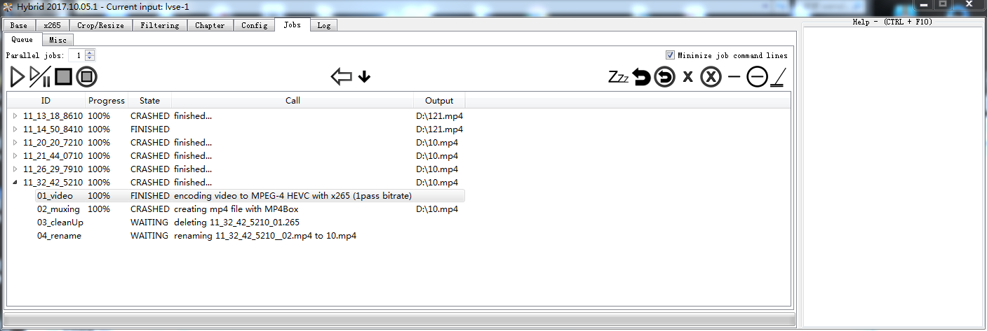

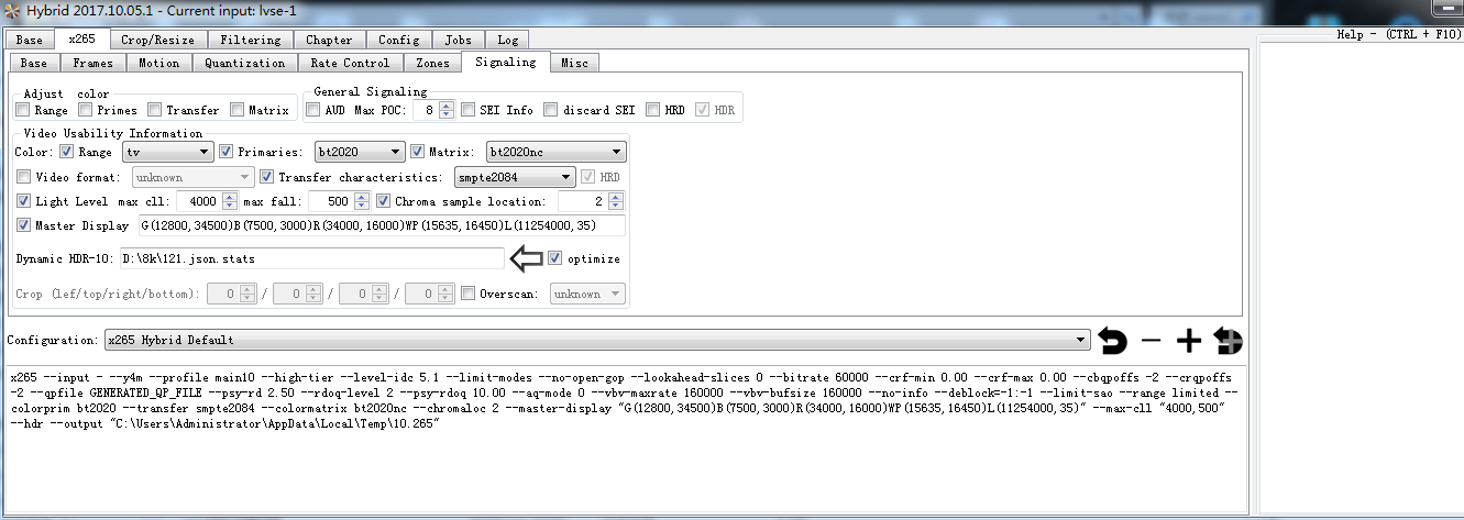

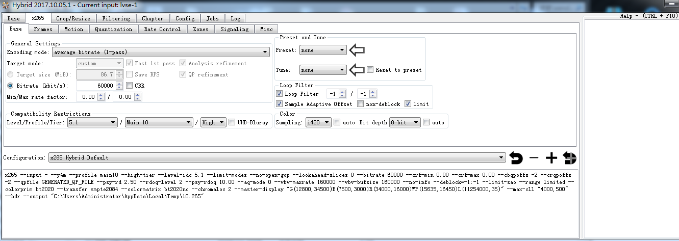

Hi Selur
I set up Hybrid to output several times according to the suggestion you gave me, and the output was destroyed. Specific settings I added screenshots to the email attachment. Hope to help me solve this problem.
Jinhui Peng
You are using a Hybrid version from '2017.10.05.1', x265 didn't support HDR-10+ back then, so I'm not surprised that Hybrid will crash when you add custom options which aren't supported by either Hybrid or x265 at that point in time.

I'm sorry, I didn't see the version information clearly. The screenshot in the attachment below is set to output with the latest version of hybrids, but the result is the same. I don't know if there is a problem with my settings.
