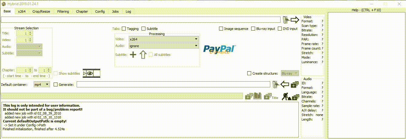

I attached gif file, probably a bug?

a. No, bug. Everything is as it should be.
