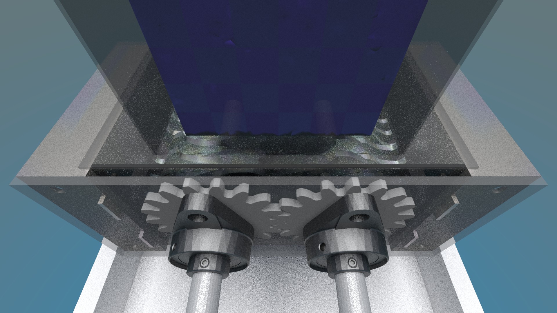

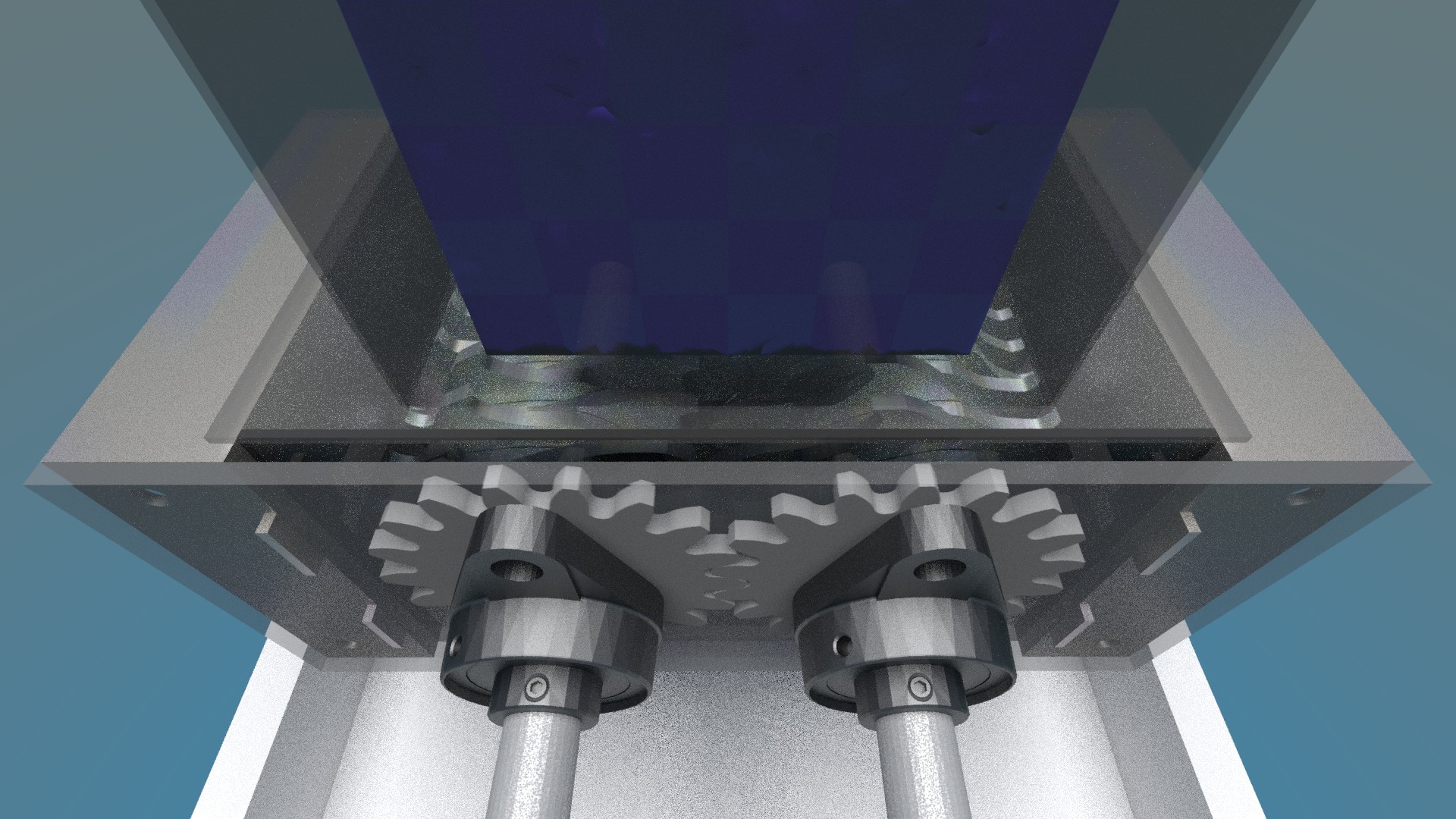

i am trying to make a few movies out of image sequences in different folders, however something is wrong with the jpg files in one of my folders which causes a 'video crashed' error when i try to encode with any encoder within Hybrid
the problem can be replicated by setting '2sideshredder0600.jpg' as the first frame and '2sideshredder0602.jpg' as the last frame

all i did was attempt to encode a movie out of 800 jpg's with sequential filenames, same dimensions and bit depth, etc
the video preview works correctly and plays the whole movie from the beginning to end, but it simply refuses to encode these jpg files even though it has no problems with other jpg files on my computer
