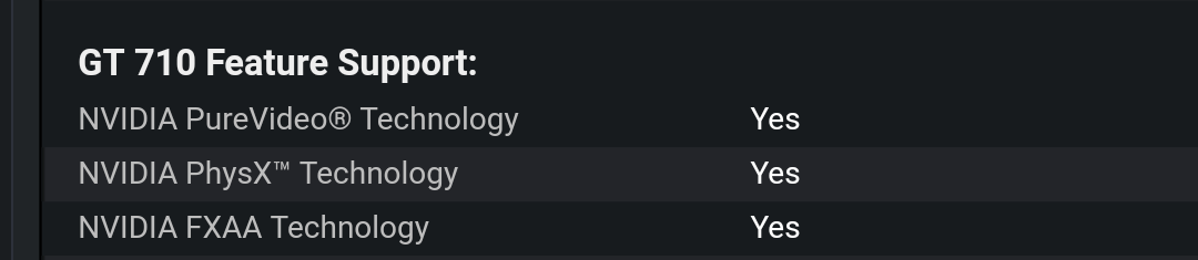

So CUDA is removed, but the card support CUDA, here is the spec:
https://www.geforce.com/hardware/desktop...ifications
How can i solve it? I couldn't force it.
Encoding requires PureVideo encoding support, not CUDA.
(18.10.2017, 01:05)Selur Wrote: [ -> ]Encoding requires PureVideo encoding support, not CUDA.
GT 710 supports PureVideo.
I was looking the list where you check the cards and the GT 710 is missing, i think that is a mistake of Nvidia
[attachment=82]
How can i do to make it works?
