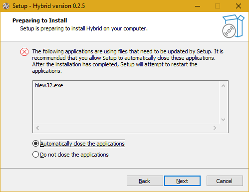

...Oh. If it were a handle/hook conflict, it would output this different message instead.
[attachment=1740]
Further, when I click [Ignore] amongst the given choices, it pops the same "Out of Memory" error again on the file "32bit\api-ms-win-core-console-l1-1-0.dll".
When [Ignore]d again, it's able to install the rest of the files tho.
[attachment=1740]
