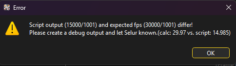

but now I'm running into an error message about fps when loading the same file:
[attachment=3410]
[attachment=3411]
Looking at the script:
Code:
# Imports
  import vapoursynth as vs
  # getting Vapoursynth core
  import ctypes
  import sys
  import os
  core = vs.core
  # Import scripts folder
  scriptPath = 'C:/Users/redacted/Documents/Programs/Hybrid/64bit/vsscripts'
  # Loading Support Files
  Dllref = ctypes.windll.LoadLibrary("C:/Users/redacted/Documents/Programs/Hybrid/64bit/vsfilters/Support/libfftw3f-3.dll")
  # loading plugins
  core.std.LoadPlugin(path="C:/Users/redacted/Documents/Programs/Hybrid/64bit/vsfilters/GrainFilter/AddGrain/AddGrain.dll")
  core.std.LoadPlugin(path="C:/Users/redacted/Documents/Programs/Hybrid/64bit/vsfilters/DenoiseFilter/NEO_FFT3DFilter/neo-fft3d.dll")
  core.std.LoadPlugin(path="C:/Users/redacted/Documents/Programs/Hybrid/64bit/vsfilters/DenoiseFilter/DFTTest/DFTTest.dll")
  core.std.LoadPlugin(path="C:/Users/redacted/Documents/Programs/Hybrid/64bit/vsfilters/Support/EEDI3m.dll") # vsQTGMC
  core.std.LoadPlugin(path="C:/Users/redacted/Documents/Programs/Hybrid/64bit/vsfilters/ResizeFilter/nnedi3/vsznedi3.dll")
  core.std.LoadPlugin(path="C:/Users/redacted/Documents/Programs/Hybrid/64bit/vsfilters/Support/libmvtools.dll")
  core.std.LoadPlugin(path="C:/Users/redacted/Documents/Programs/Hybrid/64bit/vsfilters/Support/fmtconv.dll")
  core.std.LoadPlugin(path="C:/Users/redacted/Documents/Programs/Hybrid/64bit/vsfilters/DeinterlaceFilter/Bwdif/Bwdif.dll")
  core.std.LoadPlugin(path="C:/Users/redacted/Documents/Programs/Hybrid/64bit/vsfilters/Support/libllvmexpr.dll")
  core.std.LoadPlugin(path="C:/Users/redacted/Documents/Programs/Hybrid/64bit/vsfilters/DenoiseFilter/ZSmooth/zsmooth.dll")
  core.std.LoadPlugin(path="C:/Users/redacted/Documents/Programs/Hybrid/64bit/vsfilters/SourceFilter/LSmashSource/LSMASHSource.dll")
  # Import scripts
  import qtgmc
  import validate
  # Source: 'C:\Users\redacted\Videos\Example\2011177-1-1-pass3.mkv'
  # Current color space: YUV422P10, bit depth: 10, resolution: 720x486, frame rate: 29.97fps, scanorder: bottom field first, yuv luminance scale: limited, matrix: 470bg, transfer: bt.709, primaries: bt.601 ntsc, format: FFV1
  # Loading 'C:\Users\redacted\Videos\Example\2011177-1-1-pass3.mkvÄ using LWLibavSource
  clip = core.lsmas.LWLibavSource(source="C:/Users/redacted/Videos/Example/2011177-1-1-pass3.mkv", format="YUV422P10", stream_index=0, cache=0, fpsnum=30000, fpsden=1001, prefer_hw=0)
  frame = clip.get_frame(0)
  # setting color matrix to 470bg.
  clip = core.std.SetFrameProps(clip, _Matrix=vs.MATRIX_BT470_BG)
  # setting color transfer (vs.TRANSFER_BT709), if it is not set.
    clip = core.std.SetFrameProps(clip=clip, _Transfer=vs.TRANSFER_BT709)
  # setting color primaries info (to vs.PRIMARIES_BT470_BG), if it is not set.
    clip = core.std.SetFrameProps(clip=clip, _Primaries=vs.PRIMARIES_BT470_BG)
  clip = core.std.SetFrameProps(clip=clip, _ColorRange=vs.RANGE_LIMITED)
  # making sure frame rate is set to 29.97fps
  clip = core.std.AssumeFPS(clip=clip, fpsnum=30000, fpsden=1001)
  # making sure the detected scan type is set (detected: bottom field first)
  clip = core.std.SetFrameProps(clip=clip, _FieldBased=vs.FIELD_BOTTOM) # scan type: bottom field first
  clip = core.std.AddBorders(clip=clip, left=0, right=0, top=0, bottom=2) # add borders to archive mod 4 (vsQTGMC) - 720x488
  # Deinterlacing using QTGMC
  clip = qtgmc.QTGMC(Input=clip, Preset="Slower", InputType=0, TFF=False, TR2=0, Sharpness=0.1, SourceMatch=2, Lossless=2) # new fps: 29.97
  clip = core.std.Crop(clip=clip, left=0, right=0, top=0, bottom=2) # removing added borders from mod requirement (vsQTGMC) -  720x486
  clip = core.std.SetFrameProps(clip=clip, _FieldBased=vs.FIELD_PROGRESSIVE) # scan type: progressive
  clip = clip[::2] # selecting previously even frames, new fps: 14.985
  # Resizing using 9 - lanczos
  clip = core.fmtc.resample(clip, kernel="lanczos", w=720, h=480, interlaced=False, interlacedd=False) # resolution 720x480 before YUV422P10 after YUV422P16
  # adjusting output color from YUV422P16 to YUV422P10 for ProResModel
  clip = core.resize.Bicubic(clip=clip, format=vs.YUV422P10, dither_type="error_diffusion")
  # set output frame rate to 14.985fps (progressive)
  clip = core.std.AssumeFPS(clip=clip, fpsnum=15000, fpsden=1001)
  # output
  clip.set_output()
  # script was created by Hybrid 2025.12.05.1
Hmm,.. I can't reproduce this.
I get:
Code:
# Imports
import ctypes
import sys
import os
core = vs.core
# Limit frame cache to 48449MB
core.max_cache_size = 48449
scriptPath = 'F:/Hybrid/64bit/vsscripts'
Dllref = ctypes.windll.LoadLibrary("F:/Hybrid/64bit/vsfilters/Support/libfftw3f-3.dll")
# loading plugins
core.std.LoadPlugin(path="F:/Hybrid/64bit/vsfilters/GrainFilter/AddGrain/AddGrain.dll")
core.std.LoadPlugin(path="F:/Hybrid/64bit/vsfilters/DenoiseFilter/NEO_FFT3DFilter/neo-fft3d.dll")
core.std.LoadPlugin(path="F:/Hybrid/64bit/vsfilters/DenoiseFilter/DFTTest/DFTTest.dll")
core.std.LoadPlugin(path="F:/Hybrid/64bit/vsfilters/Support/EEDI3m_opencl.dll") # vsQTGMC
core.std.LoadPlugin(path="F:/Hybrid/64bit/vsfilters/ResizeFilter/nnedi3/libsneedif.dll")
core.std.LoadPlugin(path="F:/Hybrid/64bit/vsfilters/Support/libmvtools.dll")
core.std.LoadPlugin(path="F:/Hybrid/64bit/vsfilters/Support/fmtconv.dll")
core.std.LoadPlugin(path="F:/Hybrid/64bit/vsfilters/DeinterlaceFilter/Bwdif/Bwdif.dll")
core.std.LoadPlugin(path="F:/Hybrid/64bit/vsfilters/Support/akarin.dll")
core.std.LoadPlugin(path="F:/Hybrid/64bit/vsfilters/DenoiseFilter/ZSmooth/zsmooth.dll")
core.std.LoadPlugin(path="F:/Hybrid/64bit/vsfilters/SourceFilter/BestSource/BestSource.dll")
# Import scripts
import qtgmc
import validate
# Source: 'G:\Output\test_new.mkv'
# Current color space: YUV420P10, bit depth: 10, resolution: 720x486, frame rate: 29.97fps, scanorder: top field first, yuv luminance scale: limited, matrix: 470bg, format: AV1
# Loading 'G:\Output\test_new.mkv' using BestSource
clip = core.bs.VideoSource(source="G:/Output/test_new.mkv", cachepath="J:/tmp/test_new_bestSource", track=0, hwdevice="opencl")
# setting color transfer (vs.TRANSFER_BT601), if it is not set.
  clip = core.std.SetFrameProps(clip=clip, _Transfer=vs.TRANSFER_BT601)
# making sure the detected scan type is set (detected: top field first)
clip = core.std.SetFrameProps(clip=clip, _FieldBased=vs.FIELD_TOP) # scan type: top field first
clip = qtgmc.QTGMC(clip, Preset="Fast", TFF=True, opencl=True) # new fps: 59.94
clip = clip[::2] # selecting previously even frames, new fps: 29.97
# Resizing using 10 - bicubic spline
clip = core.fmtc.resample(clip, kernel="spline16", w=720, h=480, interlaced=False, interlacedd=False) # resolution 720x480 before YUV420P10 after YUV420P16
# adjusting output color from YUV420P16 to YUV420P10 for NVEncModel
clip = core.resize.Bicubic(clip=clip, format=vs.YUV420P10, dither_type="error_diffusion")
# set output frame rate to 29.97fps (progressive)
# output
clip.set_output()
For me, the output resolution is properly calculated and I'm using the same version of Hybrid. Huh (same with a bff source with that resolution)
=> I can't reproduce this
What are the steps you are using to get this?

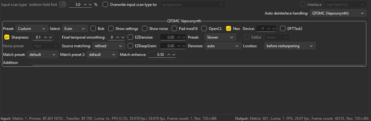

1. Changing codec to ProRes HQ accompanied with specified VUI
2. Deinterlace with QTGMC via Vapoursynth via these settings (no bob):
[attachment=3412]
3. Resizing the height from 720x486 to 720x480 via Lanczos, while specifying the input par/sar as 9x10 and outputting to 8x9
4. Render
Nothing too fancy I don't think.
Ahhh,... I know where the problem is and when I introduced this a few days ago. (I did refactor some code and overlooked the fps adjustment inside the custom part,...)

As an example, the input file I've used to troubleshoot with you was encoded as a 720x486 4:2:2 FFV1 (12 Slices and Level 3) and is about 27 minutes long. Once the file is added to the queue and has started processing, the audio .wav file was generated at 1:37pm in the local %temp% directory. The file didn't actually start encoding with ffmpeg until 1:49pm. So about 12 minutes in hang time for Vapoursynth to prep the file. This normally would've taken way less than that.
Ahh, nevermind. It potentially looks to be a change in LWLibavSource. When changing the source viewer to 'Prefer Best Source' ,it speeds it up dramatically, but still not quite to the same level as way before
