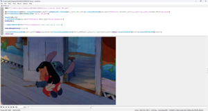

[Image: ME1BA9FU_t.png]
Hi Selur, avspmod isn't giving me any errors.
I copied the plugins to the directory where your program's plugins are located, but I'm still getting errors. I haven't included `SelectRangeEvery`.
Thanks and regards.
1. With "check the Avisynth preview, "
I was referring to the "Avisynth Preview" in Hybrid, not some other Avisynth preview like avsmod.
