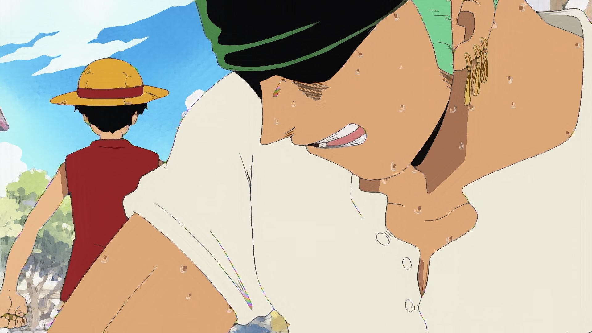

[Image: vlcsnap.jpg]Hi everyone,
I’m having trouble improving the quality of an anime video and I can’t seem to fully fix it.
Source info:
  • FPS: 29.970
  • I already processed it with SRestore to get back to 23.976 fps
  • I also used QTGMC to fix interlacing
Current issue:
There are still a lot of small bright and colored pixels around the lineart (edges). It looks like strong compression artifacts (ringing / mosquito noise), almost like an over-compressed JPEG.
What I already tried in Hybrid:
  • DeHaloAlpha (Radius 2, Strength 1–2)
  • HQDeRing (Y + U + V checked)
  • Deband (f3kdb Neo, light settings)
Despite this, the pixels around the lines are still very visible.
What I’m looking for:
  • Best way to reduce/remove these artifacts without destroying line detail
  • Recommended filters or settings in Hybrid / VapourSynth
  • Whether this can be properly fixed or if it’s just a limitation of the source
If needed, I can provide screenshots or a sample.
Thanks a lot for your help! [attachment=3543]

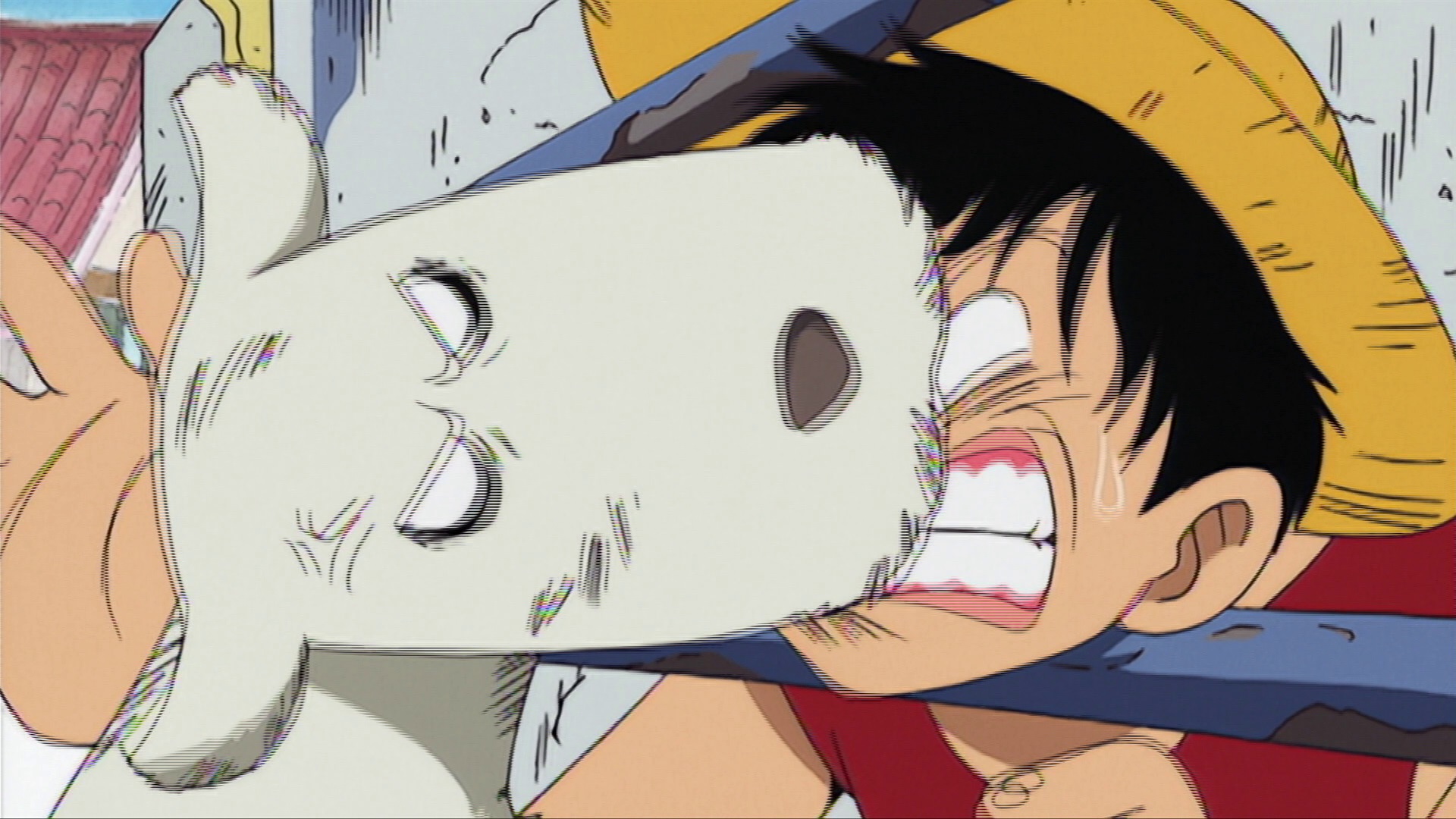

I’m still seeing some artifacts, so I’ve attached a short sample clip to better show the issue (especially around the lineart).
If you have any recommendations for the best settings or filters to reduce this without losing detail, I’d really appreciate it.

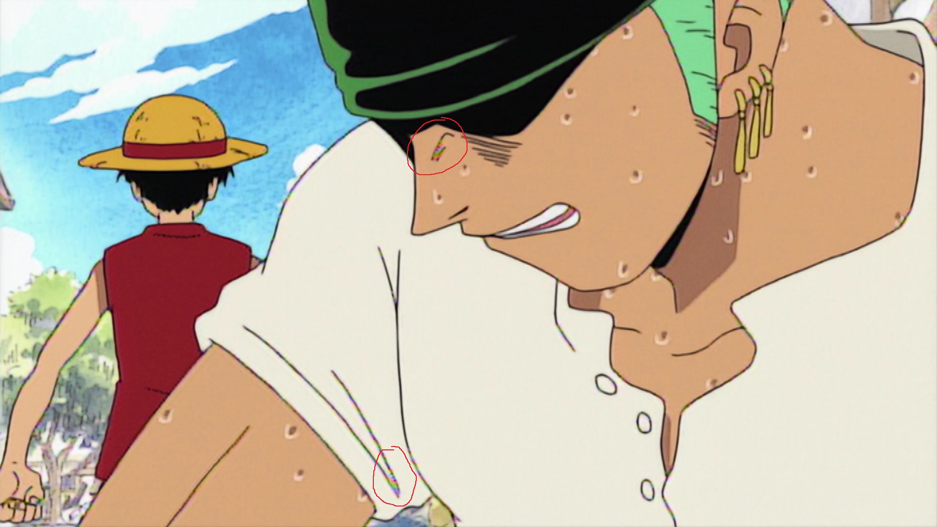

Issues I see with the source:
  • content is "(soft) telecined" => "Filtering->(De-)Interlace/Telecine->Overwrite input scan type to" should be enabled and set to "telecine (soft)", if you have an NVIDIA GPU also enable "Filtering->Vapoursynth->Source->Use DGDecNV when available"
  • compression artifacts where banding turned into artifacts after due to recompression
  • baldy handled dot crawlers turned badly filtered and turned into general artifacts (thus normal dot craw will not work)
  • rainbow artifacts
=> you will probably lose details to address all of these
