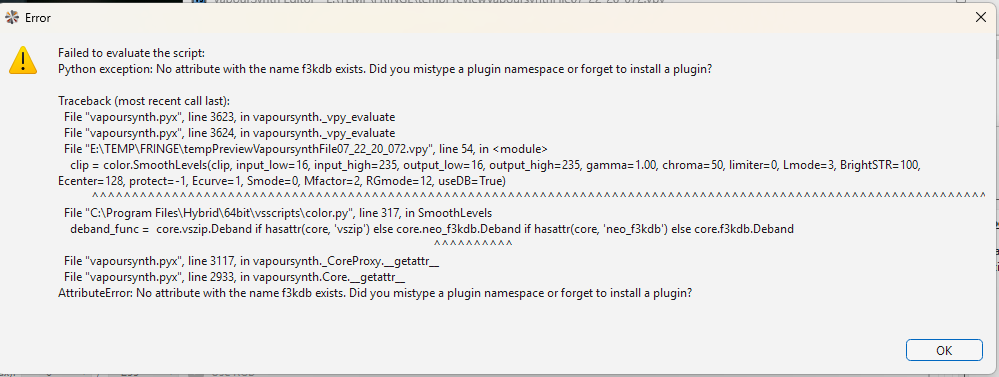

Hello,
Since the installation of hybrid 2026.06.18.1  i get the following error to see when Smooth Level collor correction is enabled.
[Image: smooth-color-error.png]
Code:
2026-06-19 07:20:18.185 Plugin C:/Program Files/Hybrid/64bit/vsfilters/SourceFilter/LSmashSource/LSMASHSource.dll is using API3 which is deprecated and will be removed shortly. 2026-06-19 07:20:37.801 Script was successfully evaluated. Output video info: Frames: 3110 | Time: 0:51:50.000 | Size: 3840x1080 | FPS: 1/1 = 1 | Format: YUV420P8 2026-06-19 07:20:37.840 Plugin C:/Program Files/Hybrid/64bit/vsfilters/SourceFilter/LSmashSource/LSMASHSource.dll is using API3 which is deprecated and will be removed shortly. 2026-06-19 07:21:26.013 [VSE Server]: incoming connection [VSE Server]: ConnectedState [VSE Server]: socket is ready to be read [VSE Server]: connection open: true [VSE Server]: connection readable: true [VSE Server] - Message received: changeTo ### E:\TEMP\FRINGE\tempPreviewVapoursynthFile07_21_25_995.vpy ### 2026-06-19 07:21:26.020 Plugin C:/Program Files/Hybrid/64bit/vsfilters/SourceFilter/LSmashSource/LSMASHSource.dll is using API3 which is deprecated and will be removed shortly. 2026-06-19 07:21:26.422 Script was successfully evaluated. Output video info: Frames: 3110 | Time: 0:51:50.000 | Size: 3840x1080 | FPS: 1/1 = 1 | Format: YUV420P8 2026-06-19 07:21:26.529 Plugin C:/Program Files/Hybrid/64bit/vsfilters/SourceFilter/LSmashSource/LSMASHSource.dll is using API3 which is deprecated and will be removed shortly. 2026-06-19 07:21:39.003 [VSE Server]: socket is ready to be read [VSE Server]: connection open: true [VSE Server]: connection readable: true [VSE Server] - Message received: changeTo ### E:\TEMP\FRINGE\tempPreviewVapoursynthFile07_21_38_985.vpy ### 2026-06-19 07:21:39.017 Plugin C:/Program Files/Hybrid/64bit/vsfilters/SourceFilter/LSmashSource/LSMASHSource.dll is using API3 which is deprecated and will be removed shortly. 2026-06-19 07:21:39.435 Script was successfully evaluated. Output video info: Frames: 3110 | Time: 0:51:50.000 | Size: 3840x1080 | FPS: 1/1 = 1 | Format: YUV420P8 2026-06-19 07:21:39.559 Plugin C:/Program Files/Hybrid/64bit/vsfilters/SourceFilter/LSmashSource/LSMASHSource.dll is using API3 which is deprecated and will be removed shortly. 2026-06-19 07:21:49.086 [VSE Server]: socket is ready to be read [VSE Server]: connection open: true [VSE Server]: connection readable: true [VSE Server] - Message received: changeTo ### E:\TEMP\FRINGE\tempPreviewVapoursynthFile07_21_49_069.vpy ### 2026-06-19 07:21:49.098 Plugin C:/Program Files/Hybrid/64bit/vsfilters/SourceFilter/LSmashSource/LSMASHSource.dll is using API3 which is deprecated and will be removed shortly. 2026-06-19 07:21:49.488 Script was successfully evaluated. Output video info: Frames: 3110 | Time: 0:51:50.000 | Size: 3840x1080 | FPS: 1/1 = 1 | Format: YUV420P8 2026-06-19 07:21:49.602 Plugin C:/Program Files/Hybrid/64bit/vsfilters/SourceFilter/LSmashSource/LSMASHSource.dll is using API3 which is deprecated and will be removed shortly. 2026-06-19 07:22:02.134 [VSE Server]: socket is ready to be read [VSE Server]: connection open: true [VSE Server]: connection readable: true [VSE Server] - Message received: changeTo ### E:\TEMP\FRINGE\tempPreviewVapoursynthFile07_22_02_127.vpy ### 2026-06-19 07:22:02.155 Plugin C:/Program Files/Hybrid/64bit/vsfilters/SourceFilter/LSmashSource/LSMASHSource.dll is using API3 which is deprecated and will be removed shortly. 2026-06-19 07:22:02.572 Script was successfully evaluated. Output video info: Frames: 3110 | Time: 0:51:50.000 | Size: 3840x1080 | FPS: 1/1 = 1 | Format: YUV420P8 2026-06-19 07:22:02.718 Plugin C:/Program Files/Hybrid/64bit/vsfilters/SourceFilter/LSmashSource/LSMASHSource.dll is using API3 which is deprecated and will be removed shortly. 2026-06-19 07:22:20.084 [VSE Server]: socket is ready to be read [VSE Server]: connection open: true [VSE Server]: connection readable: true [VSE Server] - Message received: changeTo ### E:\TEMP\FRINGE\tempPreviewVapoursynthFile07_22_20_072.vpy ### 2026-06-19 07:22:20.102 Plugin C:/Program Files/Hybrid/64bit/vsfilters/SourceFilter/LSmashSource/LSMASHSource.dll is using API3 which is deprecated and will be removed shortly. 2026-06-19 07:22:20.535 Failed to evaluate the script: Python exception: No attribute with the name f3kdb exists. Did you mistype a plugin namespace or forget to install a plugin? Traceback (most recent call last): File "vapoursynth.pyx", line 3623, in vapoursynth._vpy_evaluate File "vapoursynth.pyx", line 3624, in vapoursynth._vpy_evaluate File "E:\TEMP\FRINGE\tempPreviewVapoursynthFile07_22_20_072.vpy", line 54, in clip = color.SmoothLevels(clip, input_low=16, input_high=235, output_low=16, output_high=235, gamma=1.00, chroma=50, limiter=0, Lmode=3, BrightSTR=100, Ecenter=128, protect=-1, Ecurve=1, Smode=0, Mfactor=2, RGmode=12, useDB=True) ^^^^^^^^^^^^^^^^^^^^^^^^^^^^^^^^^^^^^^^^^^^^^^^^^^^^^^^^^^^^^^^^^^^^^^^^^^^^^^^^^^^^^^^^^^^^^^^^^^^^^^^^^^^^^^^^^^^^^^^^^^^^^^^^^^^^^^^^^^^^^^^^^^^^^^^^^^^^^^^^^^^^^^^^^^^^^^^^^^^^^^^^^^^^^^^^^^^^^^^^^^^^^^^^^^^^^^^^^^^^^^ File "C:\Program Files\Hybrid\64bit\vsscripts\color.py", line 317, in SmoothLevels deband_func = core.vszip.Deband if hasattr(core, 'vszip') else core.neo_f3kdb.Deband if hasattr(core, 'neo_f3kdb') else core.f3kdb.Deband ^^^^^^^^^^ File "vapoursynth.pyx", line 3117, in vapoursynth._CoreProxy.__getattr__ File "vapoursynth.pyx", line 2933, in vapoursynth.Core.__getattr__ AttributeError: No attribute with the name f3kdb exists. Did you mistype a plugin namespace or forget to install a plugin?
This is what the Log reports.
I hope "smooth level" is still supported..
Thank you in advance,
Yeah, I just adjusted tons of scripts to support newer filters, and I made some mistakes. Smile
Uploaded a new dev, let me know whether that fixes the problem for you.
(19.06.2026, 13:59)Selur Wrote: [ -> ]Yeah, I just adjusted tons of scripts to support newer filters, and I made some mistakes. Smile
Ah.. i thought as much..
Iam glad the filter is still supported though 👍🏽.
(19.06.2026, 13:59)Selur Wrote: [ -> ]Uploaded a new dev, let me know whether that fixes the problem for you.
SPLENDID 😉👌🏽
