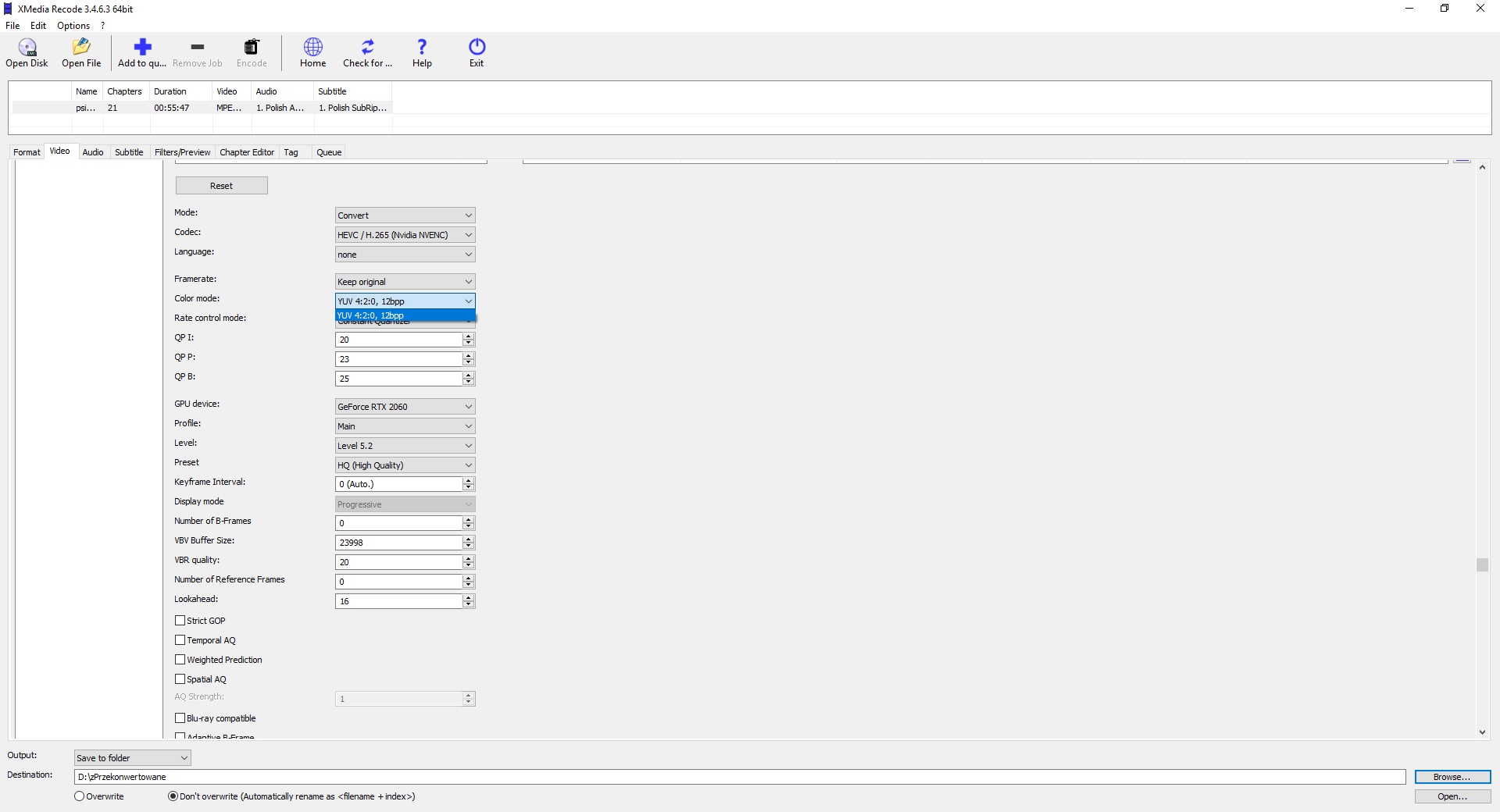

No 12bit conversion in Nvenc h265 settings
I have no option like in topic name.I have rtx 2060 which supports 12bit video encoding using Nvenc. Why this setting is not available?How i can enable 12bit color?

PS:Im using latest version of hybrid.2019.05.05.1

PS: Look at attachment.
Media info reports 8 bit depth after conversion but video is bigger than 10 bit.

Why its named 12bit when mediainfo sees 8 bit?
a. No clue about the tool you used, but normally you would need to used Main12 as profile to use 12bit encoding.
b. Could be a bug in MediaInfo.
