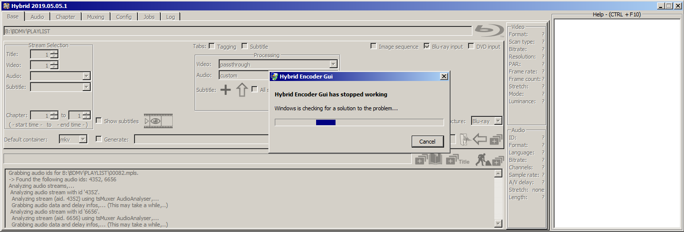

• After scanning .mpls files, it gives me a list of files to analyze; I select only the longest one. At "Grabbing audio data and delay infos", "Hybrid Encoder Gui" produces a generic "stopped working"/"checking for a solution" Windows dialog:
• Debug output (at level 4 default): [attachment=686]

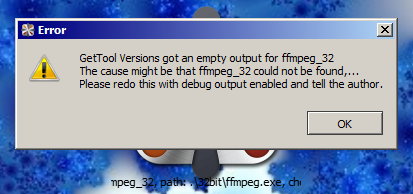

I again did a complete uninstall with all settings removed. Did a fresh install into a new location. Upon first run I'm greeted with this:
Once I rename
ffmpeg as per above, Hybrid still crashes analyzing the same stream: [attachment=689]
