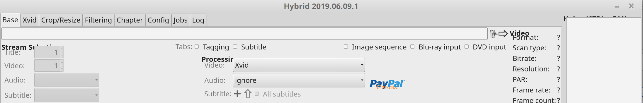

Kybos
BTW: Some UI elements (typically the bold headers on almost all tabs) look displaced on a 4k screen. Is this known/relevant/important enough? Should I open a separate ticket for it?
