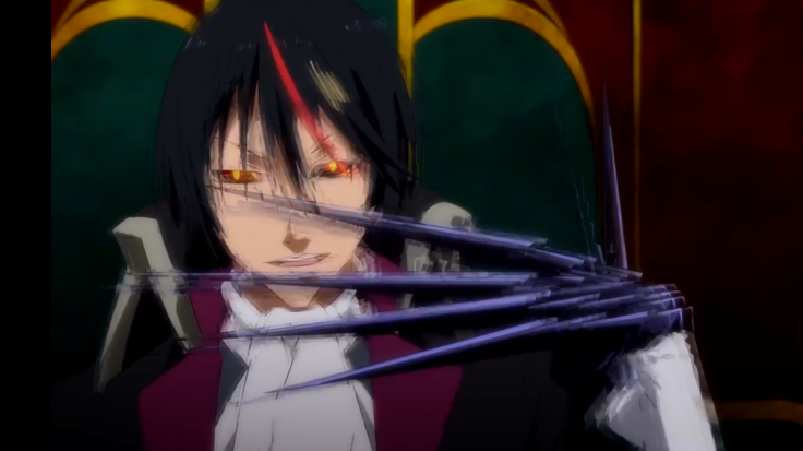

Well, I'm using Google Translate, I'm Brazilian, I was using some settings and to convert to 60 fps, but when I go to watch after converting to 60 fps it appears these things other than what they are, how can I fix this?
https://prnt.sc/qiaasz
Let me start with: I can't really recommend any special anime settings since I:
a. rarely use frame interpolation
b. even more rarely encode animes
Also be aware that: There's is no real guarantied way to avoid interpolation artifacts during interpolation.
Depending on the source you should:
  • try different interpolation methods and settings, different interpolation methods and filters sometimes work better with different sources.
  • try settings other users used Smile
A small google search showed settings other users use, see for example https://github.com/Anime4000/IFME/wiki/A...cript:-SVP used SVP and the settings translated to:
  • Overwrite Smooth:
    {rate:{num: 120,den:1,abs:true},algo:13,mask:{area:200},scene:{}}
  • Overwrite Super:
    {scale:{up:0},gpu:1,rc:true}
  • Overwrite Analyse:
    {main:{search:{coarse:{distance:-8,bad:{sad:2000,range:24}},type:2}},refine:[{thsad:250}]}
For details about what the settings mean, checkout: https://www.svp-team.com/wiki/Manual:SVPflow
