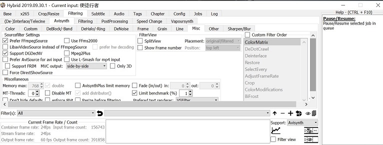

Just sent the email with debug file, hope can solve the issue. My intention is just change the originel video to 60fps, sorry for mislead about the better quality mentioned previously.
Seeing that you use Avisynth and that the decoder during the encoding call fails, check whether the 'Avisynth Preview' properly shows your video.

In case the preview fails with LWLibavVideoSource opening the video, try:
a. disabling 'Filtering->Avisynth->Misc->Sourcefilter Settings->prefer hw decoding'.
b. whether it helps to rename the video and folder to ascii characters.

Hi, I just follow your advised to disable the prefer hw decoding, plus enble the prefer FFmpegsource to start the video encoding, no issue. Although take very long time to process, the video 60fps quality is superb, love the outcome, thanks.
