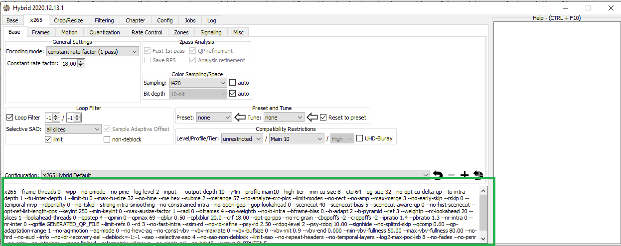

Why not just add an option to manually edit it here (see screenschot)?
It is easier for me to just add my own x265 settings instead of going through multiple tabs of x265 settings.
Quote:Why not just add an option to manually edit it here (see screenschot)?
Because, that would be a pain to keep the GUI in sync with those changes.
-> not happening
No problem. I will use Simple x264/x265 Launcher for now.
I wish you good luck!
You could simply replace the x265 binary with a newer one,.. but no problem.
