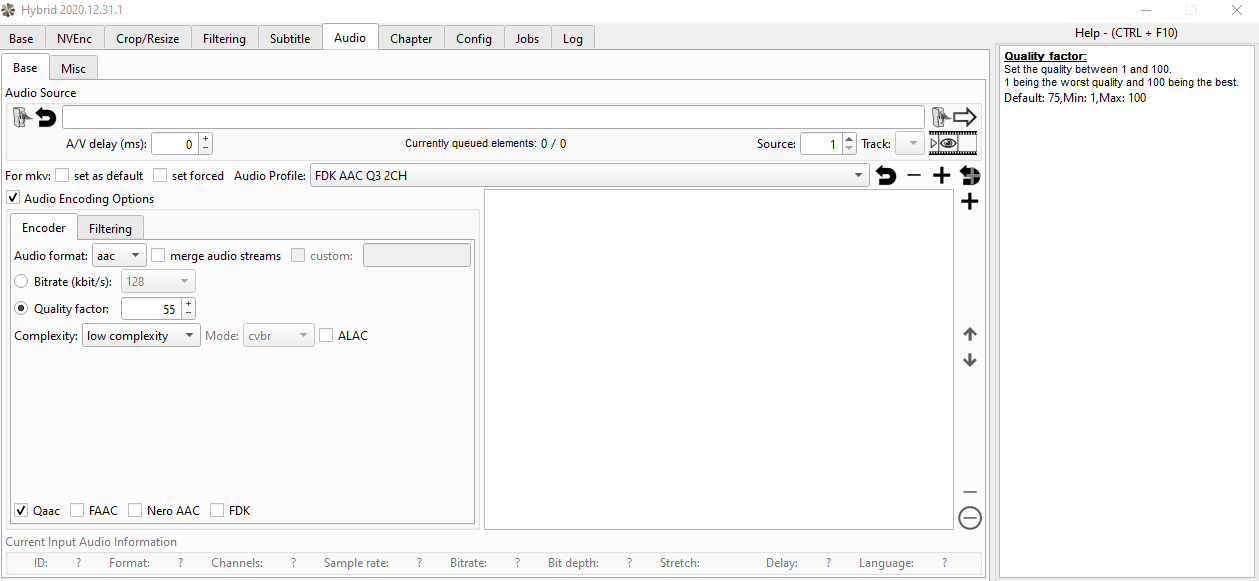

The settings for Qaac are the following:

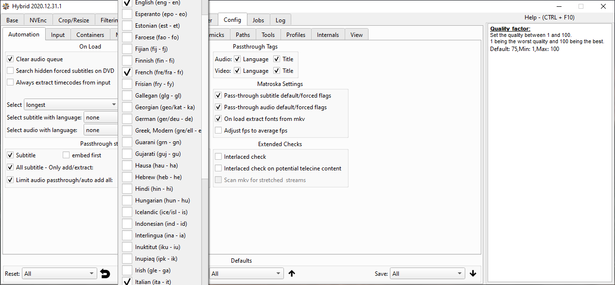

Moreover I setup the limit audio language as the following:
