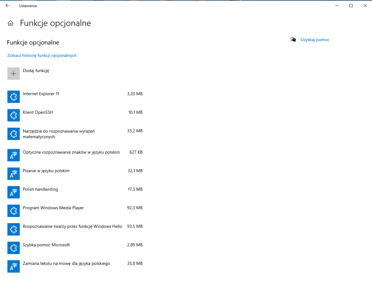

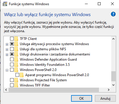

looks like I can't uninstall PowerShell cause it doesn't existing in app function. Only thing I can is disable.. something called... camera PowerShell (First Screen).
Ofcourse I did it and Hybrid still don't want cooperate.

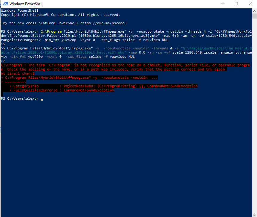

Strange thing is that the calls seem to be correct and Xvid encoding does work fine here.
If you have another antivirus/firewall software running on that machine try whether disabling it helps.

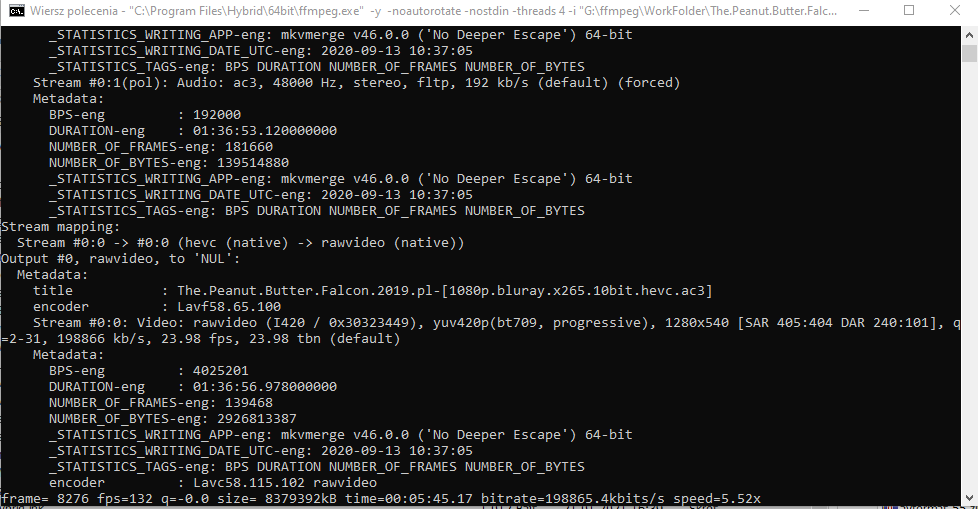

Hello,
sorry for renew this thread. I wanted to try once more. I discovered that coversion is doing like u said. Just processing bar isn't sbowing. It's iritating bug.
It's also weird cause he is showing when convert audio. When start to processing video Just dissappear. I musi something install? Or what could be wrong?
Thanks for your time
Greetings.
#25
Okay, it's just the progress indication try deleting (or renaming) Hybrid\64bit\xvid_encraw.exe, restarting Hybrid, recreating the job and running the job. Hybrid should now use mencoder as Xvid encoder.
If that helps it's an issue with xvid_encode indicating the progress.
