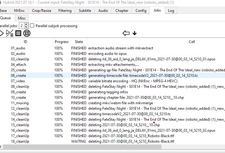

(29.07.2021, 17:38)Selur Wrote: Okay, that seems to work.
Problem was: Hybrid assumed that it had 85 unique files (giving different uids to the same file is just wrong!), so the muxing call didn't start since it assumed the missing files would be created later.
-> will build a new dev version and send you a link for testing in ~20min via pm.
I don't think the duplicates affect the muxing after another experiment while waiting for the Dev version to download:
Made 2 altered files:
In one I deleted all the font attachments and just added a single font twice, it muxes fine but there's a waiting left due to the duplicate file already being deleted:
In another I deleted the duplicates manually and added the android Roboto fonts to make it reach 100 sub jobs and it doesn't mux
[attachment=1474]
After installing the Dev version I ran the original sample and it muxed because the number of subjobs dropped below 100 (and had the nice benefit of smaller file output and not stopping a batch).
Running my no duplicate version above with the Dev also results in no mux (& job 100 running).
mux @ 11 and 100+ sub jobs is a rather unlikely combination admittedly but it's showing a bug exists somewhere...

Quote: it muxes fine but there's a waiting left due to the duplicate file already being deleted:
That was the point, of the dev verison, making sure that each file one appears once so it isn't included multiple times and thus not deleted.
But seems like there's still some problem since some files still get deleted before the muxing.
-> Looking into it.
Posts: 12.654
Threads: 70
Okay, you are right the number exceeding 99 causes a problem too. (the not properly handling the duplicates also was an issue)
What should happen is that Hybrid should go through the subjobs sorted by their number and then only execute a job if the jobs with a lower number are not hindered by it. In general this works fine. Problem is that the sorting is not by number but by string atm. so 2 > 100 etc.
-> will have to go through the source so see where this happens exactly and how to fix this.

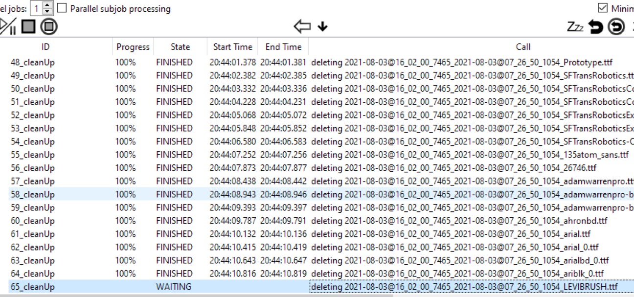

Heh, came across another edge case with matroska attachments:
Case sensitivity.
[attachment=1479]
P.S.- think you might have forgotten to delete something in the font sorting after Hybrid has finished with it: after doing a couple of batches of of series the font deletion slowed down massively with the font's starting in upper case taking 2 seconds EACH to delete, oddly the numbers then lower case ones deleted almost immediately? fixed after a restarting hybrid.

Posts: 12.654
Threads: 70
I can reproduce the problem.
Will look at it and hopefully fix it tomorrow after work.
Posts: 12.654
Threads: 70
I see the problem.
Once the font is added as:
"2021-08-03@07_26_50_1054_LEVIBRUSH.TTF"
and once as
"2021-08-03@07_26_50_1054_LEVIBRUSH.ttf"
on any OS aside from Windows that would be two different file names,.. :/
-> will write a workaround for it after work.
