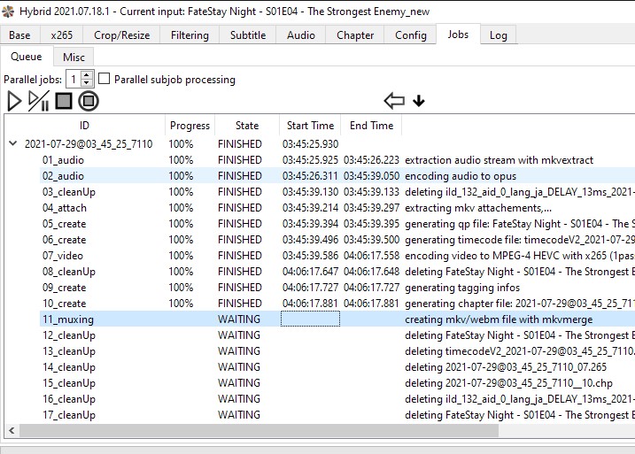

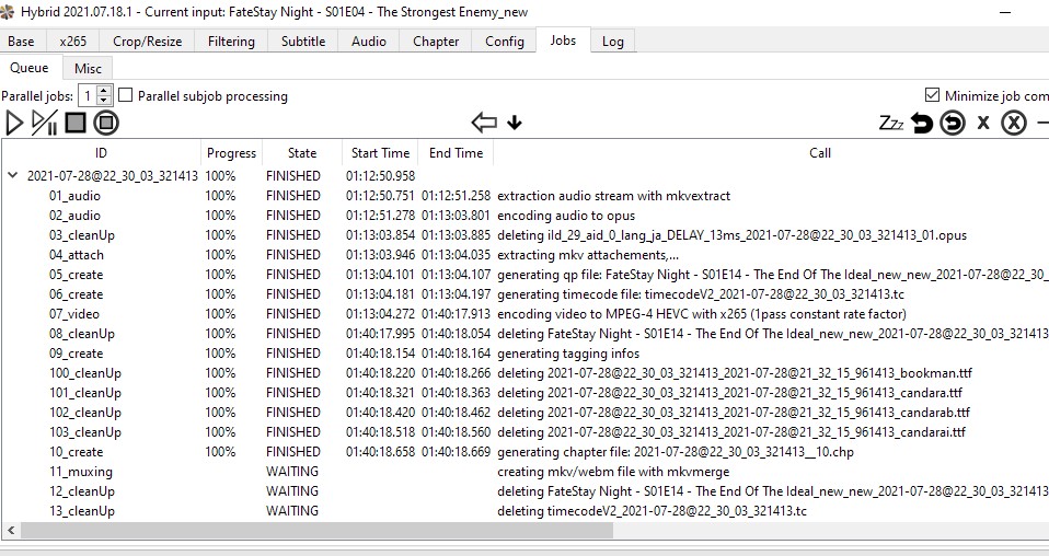

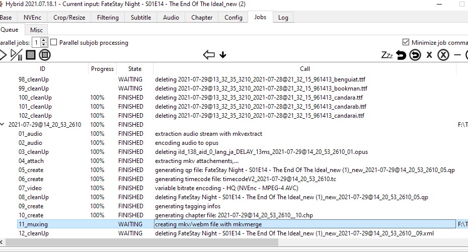

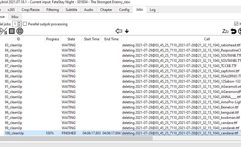

Send you a link to a dev version via pm, where I added:
a. an option to create sub-folders per job (Config->Paths->Create sub-folder per job in temp path)
b. one can right click on a job and 'clear temp folder', if the name of the temp folder is the same as the jobname the folder will simply be deleted otherwise everything in the folder will be deleted, but the folder itself will be kept.
Only did a few tests, so there could still be some issued with this.
Since you handle mkvs with lots of attachments you also might want to call "Config->Paths->Clear custom fonts folder from time to time".

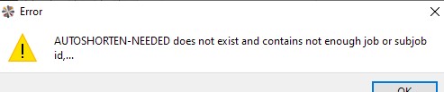

#27

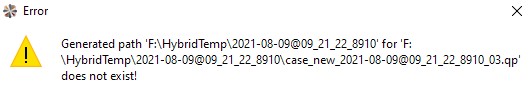

hmmn, seem to get random some part missing msg's when queueing then this:

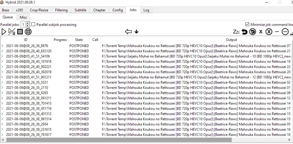

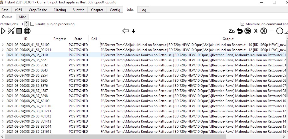

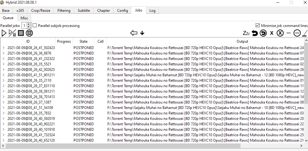

Also, not sure if related but the remaining Job queue seems to get randomly sorted every time I start Hybrid?
#28
Quote:hmmn, seem to get random some part missing msg's when queueing then this:
That message is due to the changes, it happens when Hybrid want's to get a short file name from the OS for a file that does not exist.
-> a debug output would be helpful.
Quote:Also, not sure if related but the remaining Job queue seems to get randomly sorted every time I start Hybrid?
-> I can reproduce that so I'll look into that. Smile
#29
Selur Wrote:-> a debug output would be helpful.
[attachment=1492]
What does change the order of the jobs or the subjobs?
Got an example?
The jobs should be sorted by name
Manually Sorted:
Close program then open program:
#30
I found the issue with the sorting, will send you a fixed version.
Jobs should now be sorted alphabetically on save and reload.
-> will send you a link to a dev version in a few minutes.
