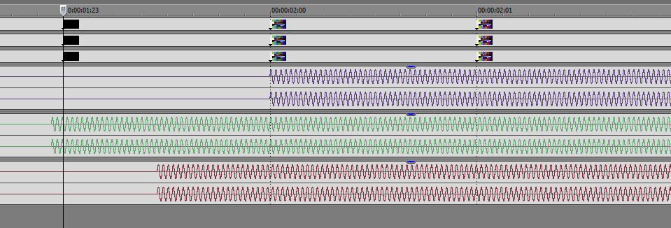

I did a quick test with 5.1 audio, MP4Box and muxer:
(assuming VirtualDub2 properly loads and displays the audio; if this is wrong everything that follows is false)
Original:
[Image: original.png]
encoded with FDK:
[Image: fdk-no-encoder-compensation.png]
Encoded with FAAC:
[Image: faac-no-encoder-compensation.png]
Encoded with FHG
[Image: fhg-no-encoder-compensation.png]
Encoded with Nero:
[Image: nero-no-encoder-compensation.png]
Encoded with QAAC:
[Image: qaac-no-encoder-compensation.png]
So to me it looks like:
Original vs FAAC_no_encoder_compensation; audio moved half a frame backward
Original vs FDK_no_encoder_compensation: no delay
Original vs. FHG_no_encoder_compensation: audio moved ~3/4 frame backwards
Original vs Nero_no_encoder_compensation: audio moved one and a half frame backwards
Original vs QAAC_no_encoder_compensation: audio moved one and a half frame backwards
Would you agree with these findings based on the images?
Can you reproduce these findings (I attached the source)?

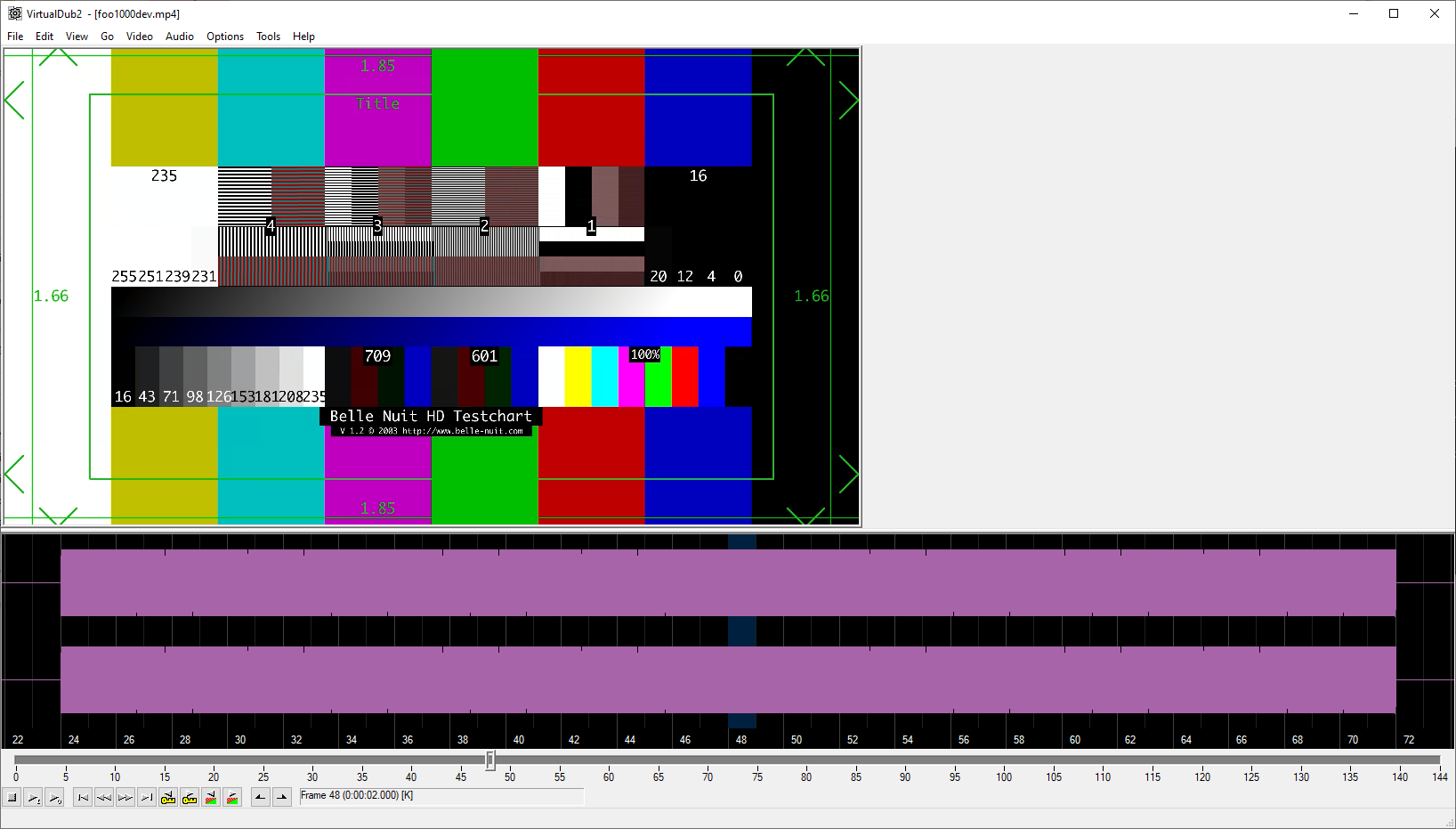

Yes, you're absolutely right. Your files indeed play (in VLC) and look (in VirtualDub2) delayed as they should be.
Nevertheless, I ran one more test with 1000 ms delay like that:
MP4Box -add foo.265#video:fps=24:delay=1000:name="" -brand hvc1 -add foo.aac -mpeg4 -new foo1000.mp4
And once again the resulting file comes with NO delay with video and audio perfectly in sync (audio starts on the 2 sec. like in the original file).
I used MP4Box from your package Hybrid, build: GPAC version 1.1.0-DEV-rev1089-gb4d25ac3b-ab-suite
Here I'm attaching my video and audio files (foo.265 and foo.aac) and the resulting file. Also, a screenshot.
Can you please try my files with the MP4Box muxing command above, and let me know what I'm doing wrong. This is really weird...

YES, it was MP4Box! I replaced it and now the delay comes where it should be. See screenshot.
So it wasn't Hybrid or VirtualDub2, it was MP4Box that was buggy. You should probably replace it in the downloadable Hybrid release too...
