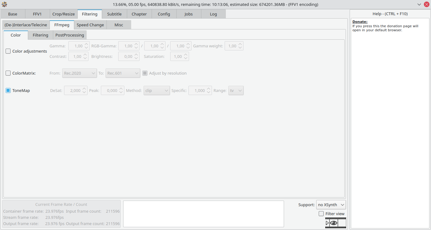

ToneMap settings are greyed out, if I encode with ToneMap enabled anyway, it fails. Source is a UHD BD remux.

I don't, but since the checkbox is not greyed out I can still enable it.
Btw, are the Avisynth and Vapoursynth tabs Windows-only? I don't have them...
this is how it looks for me:

The ToneMap button is indeed never greyed out, only the settings are, as can be seen on the screenshot. Changing the style does not change this behavior. When disabling ToneMap I get an error message: "FilteringModel get->found no field useToneMap".

Ahhh,.. there is the problem.
The "useToneMap" field accidentally was sorted to the Vapoursynth section and since Vapoursynth isn't available it doesn't work. (-> will fix)
