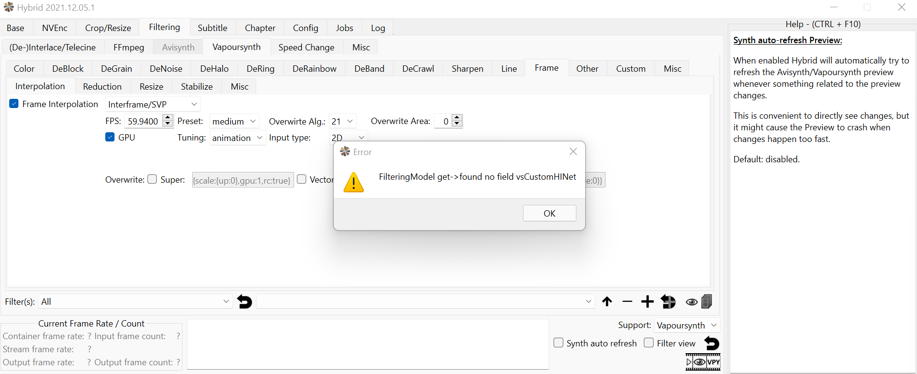

I am having trouble starting Hybrid with a script with the latest version 2021.12.05.1 on Windows 11
When I was setting up hybrid from a fresh install I got the Error messages:
FilteringModel get->found no field vsCustomHINet
FilteringModel get->found no field vsCustomHINetValue
This happened when I was creating a Vapoursynth profile as shown in the attached image.
I continued along with setting everything up and seemed to have no trouble with converting a video manually.

I know, I forgot some HINet calls, thought that this should not cause any problems aside from being annoying.
It might cause a problem with the saving and the loading of a Vapoursynth profile,...
-> will create a dev version and send you a link to it via PM, in a few minutes.
