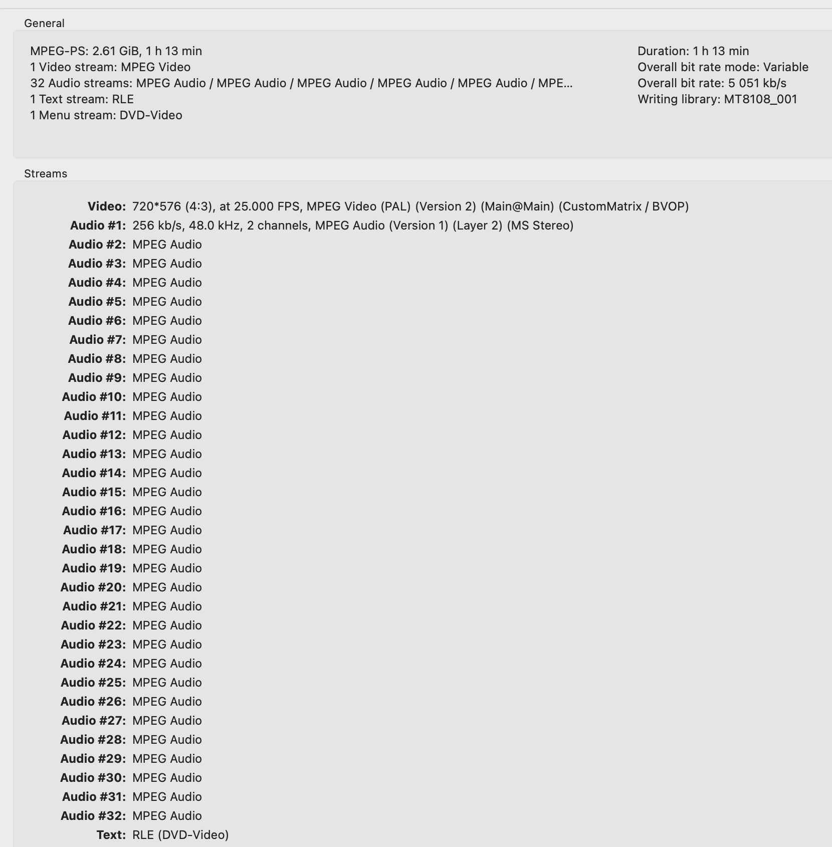

Strangely, here is the MediaInfo data for the vob file. I'm confused about all the audio tracks - it is simply a DVD-R copy from VHS.

Seems like the source filter can't handle the file (probably because of broken headers).
Try remuxing the file to mkv and open the mkv, assuming the remuxed mkv plays fine.
