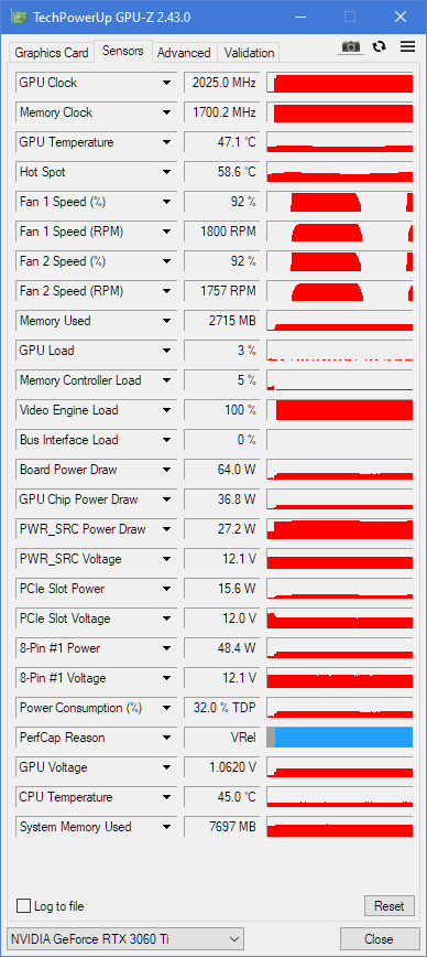

					[HELP] perf. RTX 3060 ti slower than GTX 1070 - NVEnc
		08.01.2022, 09:16
		Video engine load should be full since you use the video engine for encoding having it at a higher value only means more of the chip is used,... so usually that is not something to bother with.
To compare your results you should both use one command line and the same file for reencoding,.... Cu Selur
		08.01.2022, 10:07
	(08.01.2022, 04:36)mimile Wrote: I think you have the same problem as me while encoding, look at "video engine load" it is 99%, it is the same for me. When it is used CUDA, the encoding is performed by using the NVIDIA Video Engine. The capabilities reported by NVEnc are the capabilities reported by NVIDIA Video Engine, so it is right the it is used at 99%. Moreover I think that using a benchmark it is the right why to compare your GTX 1070 with your RTX 3060Ti. For example this is the benchmark of my RTX ![]() As you can see in this case the benchmark is 96.8%, not the best but good enough I don't have applied any overclock and this is the reason why is performing below potential. For comparison my old GTX 1070 was reported having a benchmark of about 78%.
		09.01.2022, 00:29
		it's just Selur, in gpu-z video engine load does not reflect the reality of the use of encoder, I did the test with my GTX.
So Dan64, I'll ask my question again, is your RTX 3060 100% (video encoder in Windows task manager) while encoding? this is my bench to compare : That's what I thought, the bench is therefore useless and does not reflect my problem, I already know that my RTX is more powerful than the GTX in computing and in games. So it is not logical that the GTX encodes 2x faster than the RTX with the same parameters, do we agree? Selur rightly, we must compare with the same settings: I'm using a UHD HDR10 video (2160p) of 7.34 min, 4.38 GB, it is the first minutes of the film "The Protégé", but I can't upload to uptobox ... you can use a video of your choice which is of course equivalent. my command line: NVEnc --avhw -i -INPUT- --fps 23.976 --codec h265 --profile main10 --level 5.1 --tier high --sar 1:1 --lookahead 32 --output-depth 10 --vbrhq 19769 --max-bitrate 10000 --gop-len 0 --ref 3 --bframes 0 --no-b-adapt --mv-precision Q-pel --preset quality --colorrange limited --colorprim bt2020 --transfer smpte2084 --colormatrix bt2020c --max-cll 1000,923 --master-display G(13250,34500)B(7500,3000)R(34000,16000)WP(15635,16450)L(10000000,1) --vpp-resize auto --output-res 3840x2160 --vpp-gauss disabled --cuda-schedule sync --keyfile GENERATED_KEY_FILE --output "J:\Download 10 To\4K UHD enc\The.Prote test 4.265"

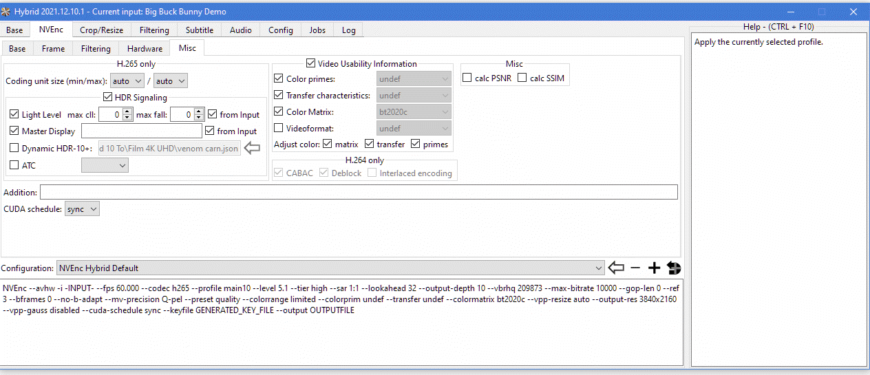

	(09.01.2022, 01:35)Dan64 Wrote: Hello, hello, Right click on the image and "open the image in a new tab"   sorry, the image didn't want to load normally ok for test with Big Buck Bunny with my setting, i'm unchek "use gpu for decoding" and not add audio track adapt the settings a bit in the nvenc "misc" tab: test result with the GTX: encoded 38072 frames, 52.49 fps, 8862.06 kbps, 670.35 MB encode time 0:12:05, CPU: 0.1, GPU: 5.9, VE: 51.7, VD: 24.3 test result with the RTX : encoded 38072 frames, 21.51 fps, 8703.42 kbps, 658.35 MB encode time 0:29:29, CPU: 0.1, GPU: 2.4, VE: 100.0, VD: 9.8 https://github.com/rigaya/NVEnc/issues/280 an other person have the same problem and rigaya only offers to lower the quality ... I tested and I have to use --preset P5 to go faster than the GTX but the gpu (video encode) is still at 100% I will see if there is a other solution with Rigaya
		09.01.2022, 13:31
		Hello,
The Rigya's answer says it all. You need to adjust your setting to match your RTX capabilities. For example the RTX is able to encode by using adaptive B-frames, while GTX 170 not, and this feature decrease the size with little impact on quality. I encoded the test movie using your settings and I obtained a speed of 20.37 fps (near to your result). ![]() As suggested by Rigaya it is better to adjust the CQP avoiding to use the VR 2pass encoding. I found that the following CQP values match your quality : 9-10-13 ![]() With this settings the speed increase to 37.41 fps. But as suggested by Rigaya it also necessary to change the preset to "default" as shown in the picture above, using this preset the speed increase to 101.63 fps, with a little decrease in PSNR (from 54.242 to 54.231) and a very little increase in SSIM (from 0.997560 to 0.997562). But I will never use your CQP because are very near to "placebo" values, this imply that you get a big size without a noticeable (using human eyes) improvement in quality. Moreover I will use the extra speed obtained, to enable the B-frames as shown in the picture below ![]() Using your implied CQP of 9-10-13 and the B-frames, the encoding size decrease to 61,253.99 kbps from 82,237.40. A decrease in size of about 25% with not noticeable decrease in quality (PSNR = 54.03, SSIM = 0.9975) and little decrease in speed (92 fps). Even if using the B-frames the size decreased significantly I will avoid to use near "placebo" values. The good in using the CQP is that you don't have to guess what is the best encoding "size" for a given movie since it depends on its content. Once you have decided what are your "acceptable" CQP settings, your are sure that all the movies will be encoded using the same quality. For example try to use the following CQP: 18-20-25 and try to see if there are noticeable differences respect to the near "placebo" values: 9-10-13. Good Luck!
