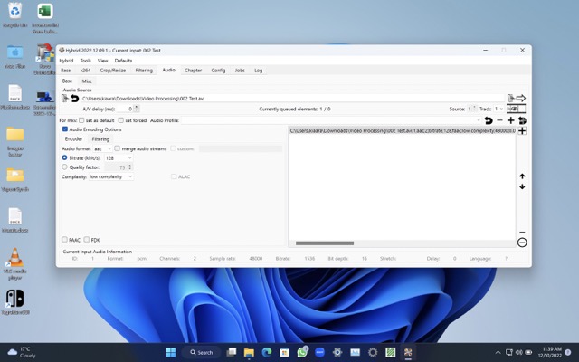

Another thing is, I am encoding x264 mp4 file with mp3 audio. but getting this issue. My final video mp4 file is without audio. Am I doing something wrong here. I tried changing temp folder also but getting same issue so reverted to default.
debug file is attached. Attaching screenshots of settings.
added new job with id 2022-12-10@11_40_31_1910 starting 2022-12-10@11_40_31_1910_01_audio@11:40:31.354 - C:\Users\kiaara\Downloads\Video Processing\1.mp4 2022-12-10@11_40_31_1910_01_audio finished after 00:00:00.302 starting 2022-12-10@11_40_31_1910_02_audio@11:40:31.665 - C:\Users\kiaara\Downloads\Video Processing\1.mp4 2022-12-10@11_40_31_1910_02_audio finished after 00:00:03.027 Couldn't get free space in folder(), assuming zero. delete C:\Users\kiaara\AppData\Local\Temp\iId_1_aid_1_DELAY_-43ms_2022-12-10@11_40_31_1910_01.wav starting 2022-12-10@11_40_31_1910_05_video@11:40:34.733 - C:\Users\kiaara\Downloads\Video Processing\1.mp4 2022-12-10@11_40_31_1910_05_video finished after 00:00:50.812 delete C:\Users\kiaara\AppData\Local\Temp\encodingTempSynthSkript_2022-12-10@11_40_31_1910.vpy starting 2022-12-10@11_40_31_1910_08_muxing@11:41:25.580 - C:\Users\kiaara\Downloads\Video Processing\1.mp4 2022-12-10@11_40_31_1910_08_muxing finished after 00:00:00.613 delete C:\Users\kiaara\AppData\Local\Temp\2022-12-10@11_40_31_1910_05.264 delete C:\Users\kiaara\AppData\Local\Temp\iId_1_aid_1_ms_2022-12-10@11_40_31_1910_02.aac Job 2022-12-10@11_40_31_1910 finished!
Quote:debug file is attached. Attaching screenshots of settings.
Nope, debug output isn't attached. Without a debug output I have no clue what is happening.
Sorry. here it is.
