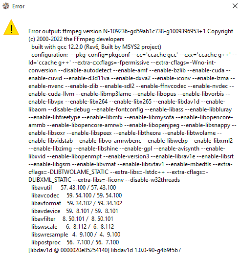

Can't encode this file to x264 mp4 container with base setting ane restriction to 7.9 mb - https://www.mediafire.com/file/d8ufpmdkd...m.mp4/file
Getting error during source analysis - https://www.mediafire.com/view/v9dv35sjl...r.png/file
I'm adjusting the audio setting from opus to mp3 to avoid audio error for this container.
