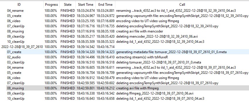

In the image attached/posted, the 3 output files seen are:
- AVI with mencoder.avi = shorter in size and duration than the other 2 files and than the original file
- MKV with mkvmerge.mkv
- AVI with ffmpeg.avi

"HybridDebugOutput - AVI with mencoder.txt" shows many lines like these:
2022.12.28 - 07:25:30_Windows 10 Version 2009 (64bit)_2022.11.28.1 - level 9: Mencoder output: Pos: 0.8s 20f ( 1%) 0.00fps Trem: 0min 1307mb A-V:0.076 [0:0]
2022.12.28 - 07:25:30_Windows 10 Version 2009 (64bit)_2022.11.28.1 - level 9: Mencoder output: Pos: 0.8s 21f ( 1%) 0.00fps Trem: 0min 1301mb A-V:0.080 [0:0]
2022.12.28 - 07:25:30_Windows 10 Version 2009 (64bit)_2022.11.28.1 - level 9: Mencoder output: Pos: 0.8s 22f ( 1%) 0.00fps Trem: 1min 1295mb A-V:0.084 [0:0]
Pos: 0.9s 23f ( 1%) 0.00fps Trem: 0min 1237mb A-V:0.048 [0:0]
2022.12.28 - 07:25:30_Windows 10 Version 2009 (64bit)_2022.11.28.1 - level 9: Mencoder output: Pos: 0.9s 24f ( 1%) 0.00fps Trem: 0min 1235mb A-V:0.052 [0:0]
Skipping frame!
