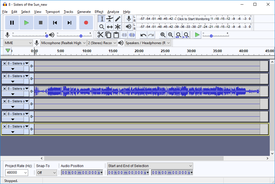

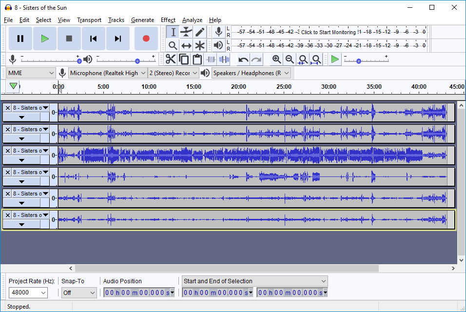

Hi.
I use '3v1' command to convert 6 channels audio to mono (just for test), but the software did not do this, the audio is still 6 channels.
The new audio is 6 channels with the third channel (3) set as full volume (v1), and other channels set to zero volume (v0).
I don't need this 6 channels audio, i want a mono audio.
How to delete channels with zero volume?
This is my source audio for test:
And this is Hybrid output with '3v1' command:

Ahh,.... do not include the other channels,
just use:
NOT
-> I you use the second, you tell Hybrid to create 6 channel output.
Feeding Hybrid with 5.1 audio and using '3v1' I just end up with mono output and the channel mapping is mono.
If that is not the case for you I need a debug output level 9 of the job creation to know what you are doing.
