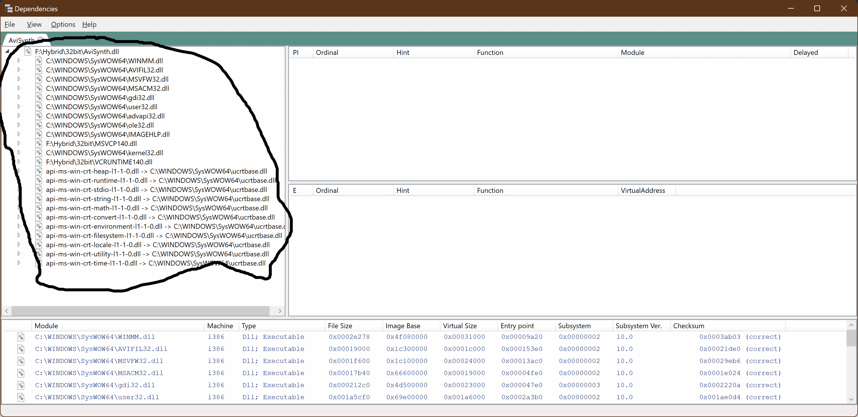

Can you use DependencyWalker (https://www.dependencywalker.com/) and test whether it reports a missing dependency for one of these files:
  • "C:\Program Files\Hybrid\32bit\avisynthPlugins\LSMASHSource.dll"
  • "C:\Program Files\Hybrid\32bit\avisynthPlugins\RgTools.dll"
  • "C:\Program Files\Hybrid\32bit\avisynthPlugins\masktools2.dll"
  • "C:\Program Files\Hybrid\32bit\avisynthPlugins\mvtools2.dll"
  • "C:\Program Files\Hybrid\32bit\avisynthPlugins\nnedi3.dll"
due to the missing dependencies, QTGMC isn't working, so no deinterlacing.
All of those files report the same error.
I'm not sure if there is a way to detail what exactly is missing as I am unfamiliar with the software.
Quote:Error: At least one required implicit or forwarded dependency was not found.
Warning: At least one delay-load dependency module was not found.
Warning: At least one module has an unresolved import due to a missing export function in a delay-load dependent module.
On the left side, you should see what dependencies are found and are missing.
