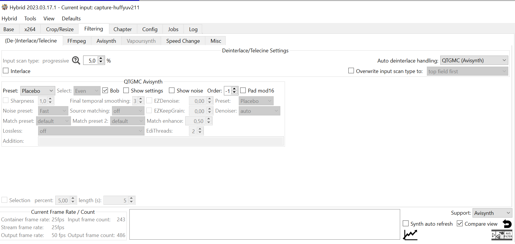

From your screenshots I see that your source is flagged as progressive, for Hybrid to deinterlace it you need to tell Hybrid that the source is interlaced (probably tff).
(Filtering->(De-)Interlace/Telecing->Deinterlace/Telecine Settings->Overwrite input scan type to)
Can't say anything about the output resolution, since there is no debug output.

Whatever codec were used in Virtualdub it still says progressive in Hybrid. Looking at the movie though it seems interlaced?!
I haven't done any post-processing after capturing the file in Virtualdub2
I have also tried tff but this was not helping me.

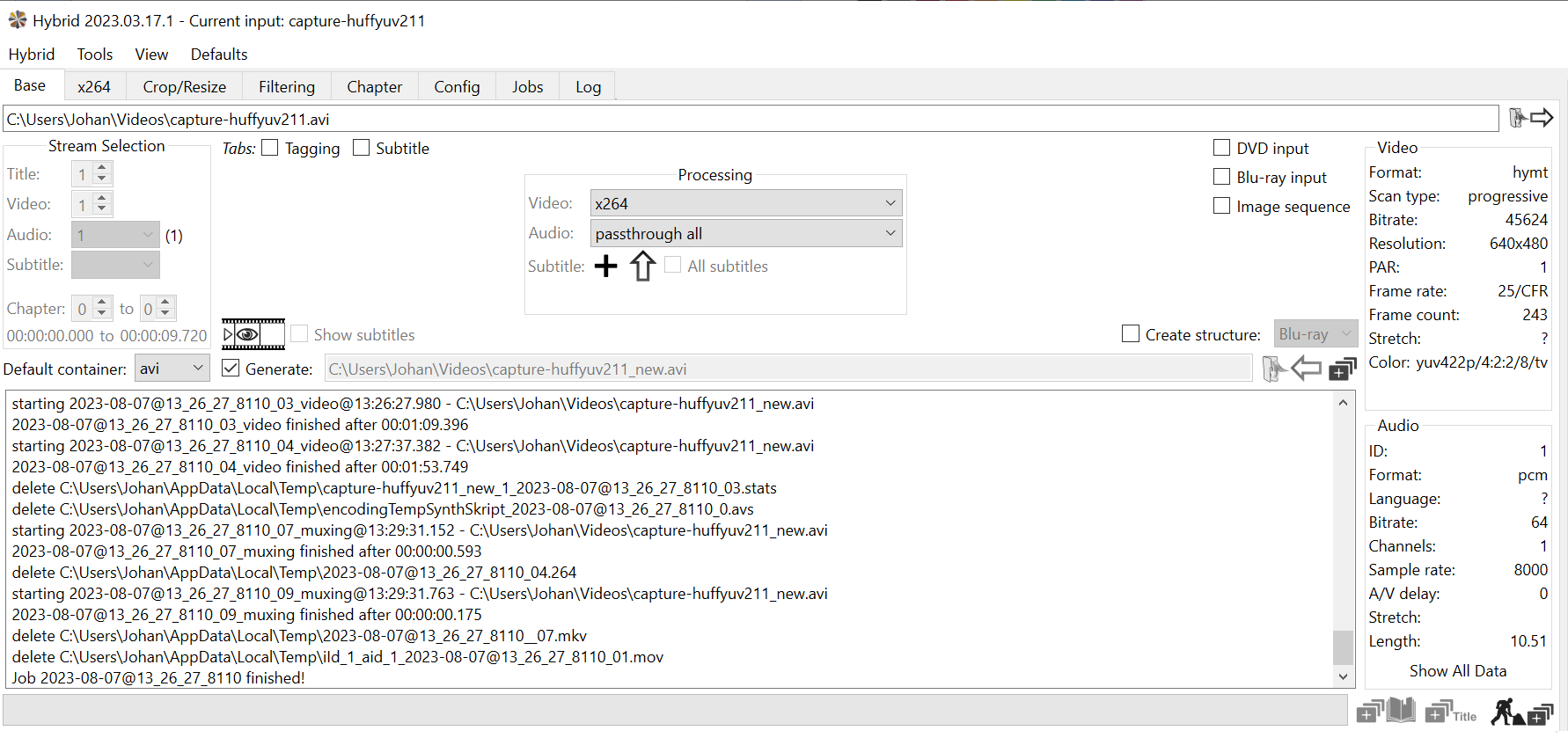

Muxing call seems fine too:
"C:\Program Files\Hybrid\64bit\ffmpeg.exe" -y -r 50/1 -i "C:\Users\Johan\AppData\Local\Temp\2023-08-07@14_10_50_6310__07.mkv" -i "C:\Users\Johan\AppData\Local\Temp\iId_9_aid_1_2023-08-07@14_10_50_6310_01.mov" -vcodec copy -acodec copy -metadata encoding_tool="Hybrid 2023.03.17.1" -map 0:0 -map 1:0 -bsf:v h264_mp4toannexb -aspect 640:480 -r 50/1 -f avi "C:\Users\Johan\Videos\capture-lagarith_new.avi"
I strongly advice NOT to use .avi for H.264 as container, better use .mkv or .mp4, multiple b-frames, open-gop and similar are 'tricky' in .avi and some players will not support it.

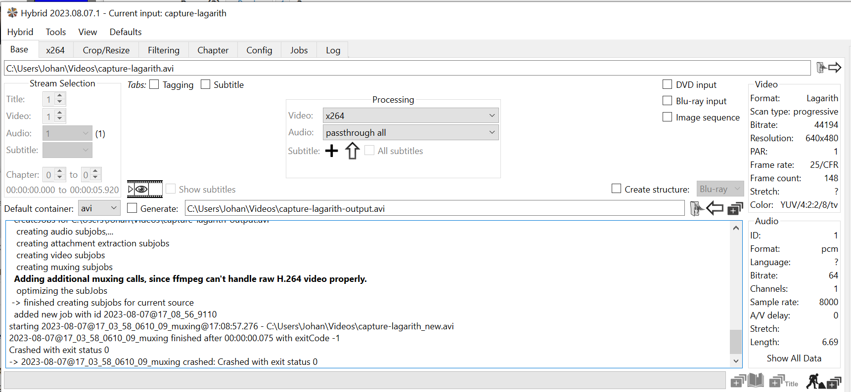

from the looks of it, ffmpeg does not like the audio.
Can you share the source file with me, so I can try to reproduce the issue?
Ps.: As a side note, you might want to switch to Vapoursynth or Avisynth 64bit, instead of using 32bit Avisynth.

Kann ich hier nachstellen, liegt am Audiostream, wenn ich den in was anderes umwandel, z.B. 32kbit/s aac und als container .mp4 nehme, geht das Multiplexen ohne Probleme.
Wenn ich als Container .mkv nehme, geht es auch mit dem original audio.
=> scheint wirklich ein Problem mit ffmpeg zu sein.

Ne ist nicht, der Audio, sondern am ffmpeg .avi muxing call, da ist ein Bug drinnen, da ich nicht davon ausgegangen bin, dass jemand H.264 in .avi packen will.
=> kann ich denke ich fixen
