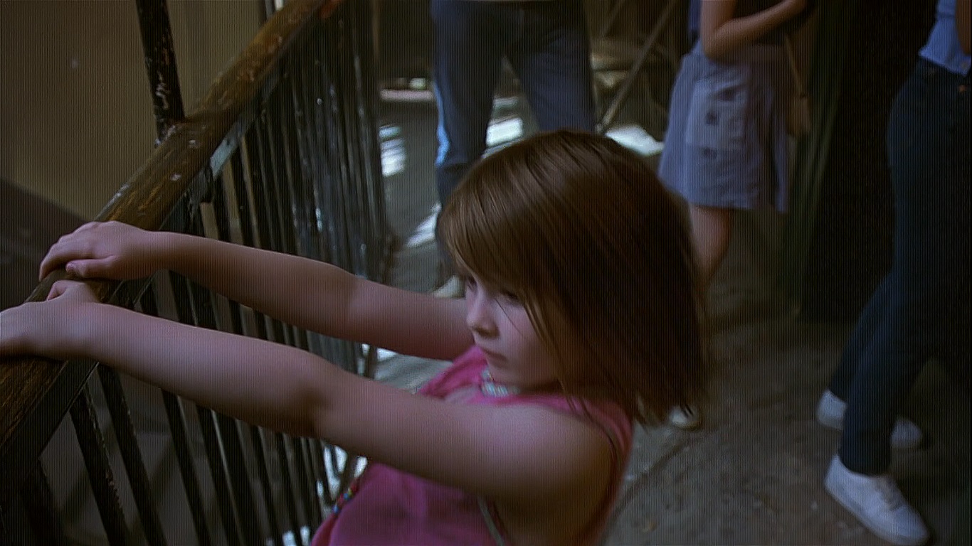

Hi.
I want help to clearing up a movie with Vertical Lines!
The first image is my original movie, and the second is my encoded with DeGrain.
What are these vertical lines? And how to clear up them?

That file doesn't have any vertical lines such as you showed,.. -> seems like this is a playback problem on your end or the wrong sample.
In case you use a Radeon card, make sure you turn off the demo or any addition filtering in the video settings in your Radeon settings.

In normal play can't see those vertical lines, but with shaders in mpchc you can see vertical lines.
Quote:In normal play can't see those vertical lines, but with shaders in mpchc you can see vertical lines.
Then what makes you think this is an artifact in the source that you can remove and not a bug in the shader implementation or mpc-hc?

Yes, In that scene you can see without any shader. but if you use shader, can see those vertical lines in the all scene.
