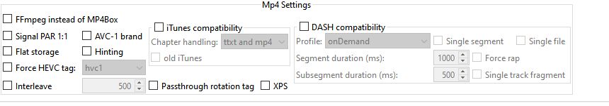

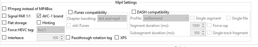

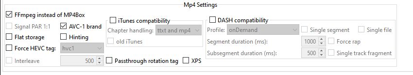

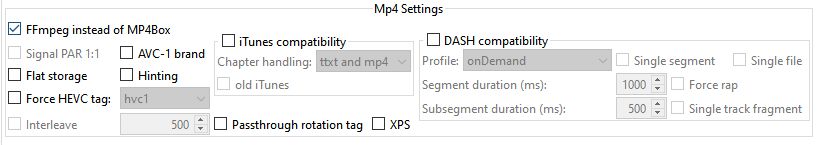

I tried 4 options (attached) and all of them are causing problems in APE.
In most cases I can play video files after putting them on APE timeline, however after moving the timeline marker a few times, the APE becomes unresponsive. There is no error message. It is not crashing. It just stopes responding and I need to kill the process in order to close the app.
Number of combinations of various options in enormous so I can't check all of them. At the same time I don't have enough knowledge to fix that problem myself.

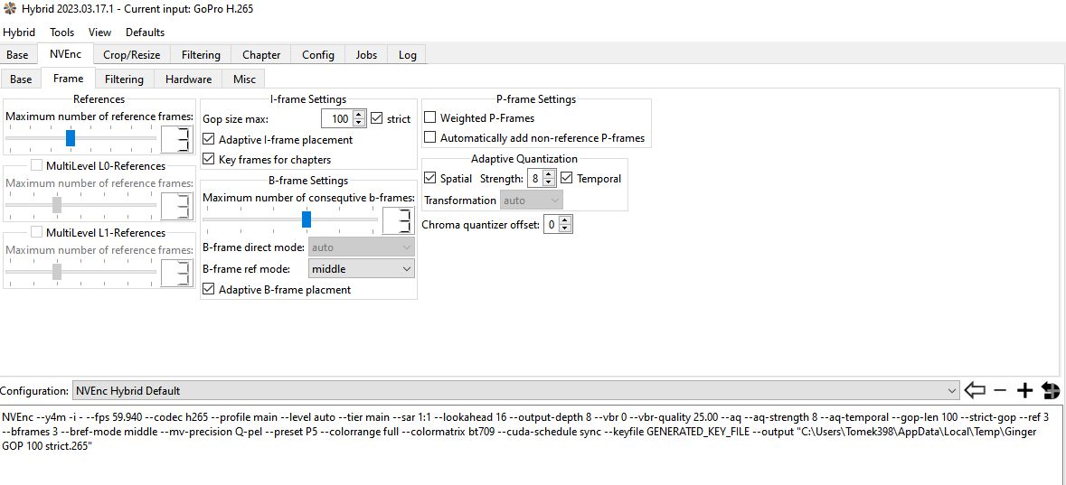

I spent a few hours testing various options and it seems that size of the GOP can fix the problem.
Everything works well is if set GOP to 100.
Here are the settings which (so far) are NOT causing problems in APE2021
I don't of 100 is the best number and why everything works when I set it to 100.
I also don't know what means when GOP is set to 0 (default value)
I need to do more reading about it. But, at least, everything seems to work now.
