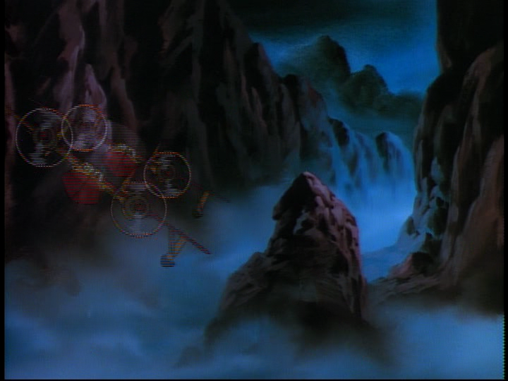

I'm hoping you can help me determine why my footage did not de-interlace with QTGMC even though it was selected in the options (or why it deinterlaced incorrectly).  MediaInfo shows the output as "Progressive", so that seems to indicate it was deinterlaced, but stepping through the frames in VLC shows plenty of frames that are clearly a blending of two interlaced frames. I can de-interlace the footage during encoding in Handbrake, and on-the-fly in VLC in a manner that avoids the issue in the screenshot, so I don't think this is an issue with the source video.

Debug and an example frame of the output are attached.  Thank you!
