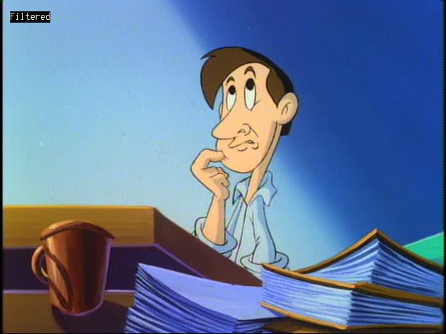

I am trying to "upscale" a video using the torch addon and the dev version 2023.11.05-101728. However, I keep running into a problem with the job crashing on the "Video" step. It shouldn't be a Vram issue, as I have a 3090 and the Vapoursynth preview works for me. I even tried tiling and it still crashed.

Script seems fine to me and the Vapoursynth preview works so, it should not be an issue with the script itself.
Try:
1. changing the default temp path (Config->Paths) before creating the job, maybe something is interfering with the piping between vspipe and x264.
2. setting an exemption in your virus scanner for the temp folder.

The Vapoursynth Preview is closed, when you start the job, right?
(Otherwise the preview would probably eat up all the gpu resources and the encoding would fail, since no more gpu resources would be available,..)
Encoding while using Vapoursynth does work, if you don't use any of the stuff from the add-ons, right?
