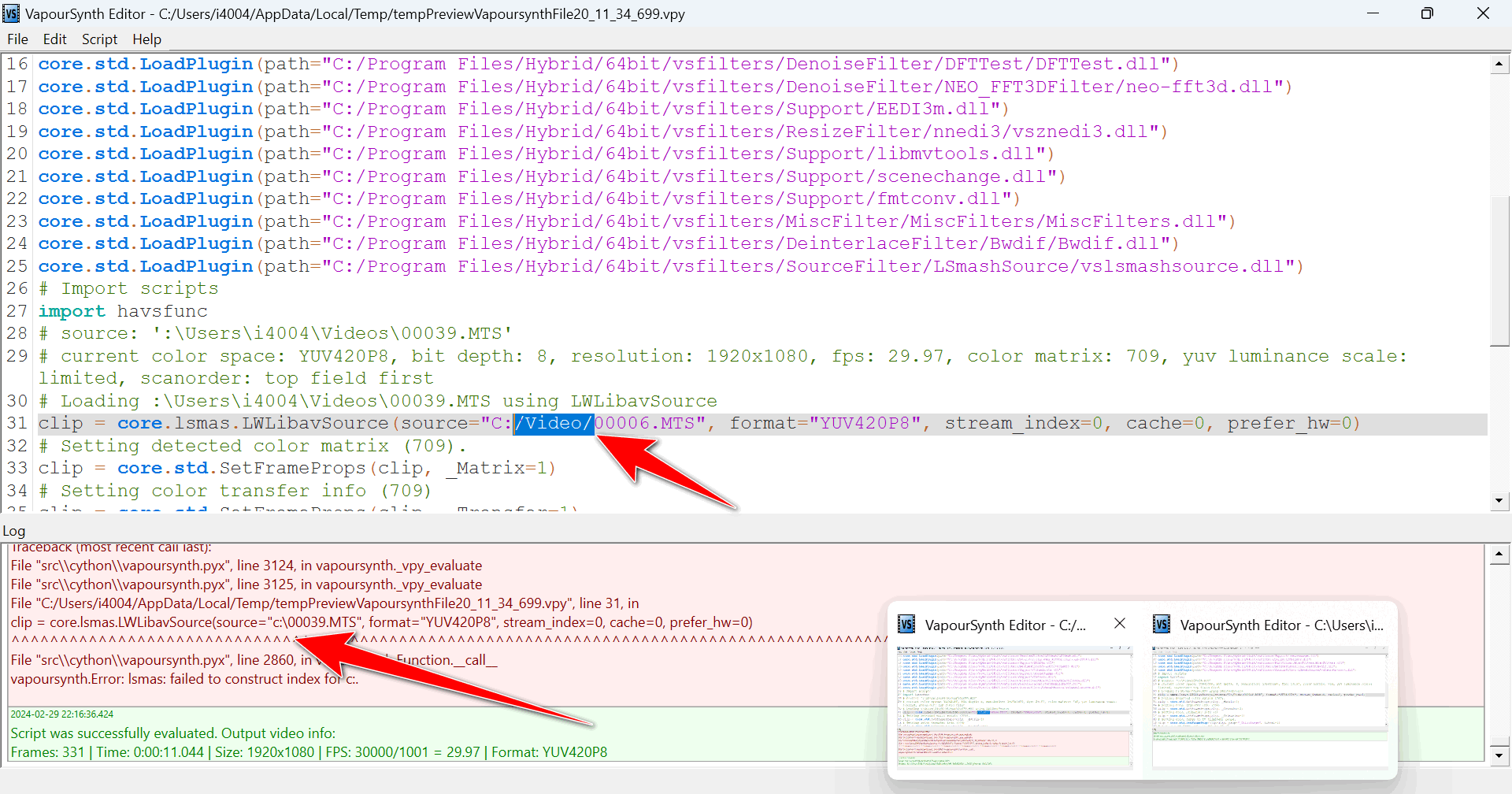

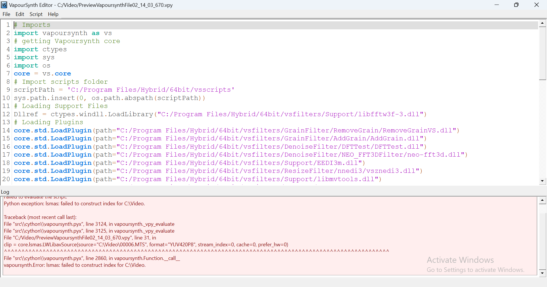

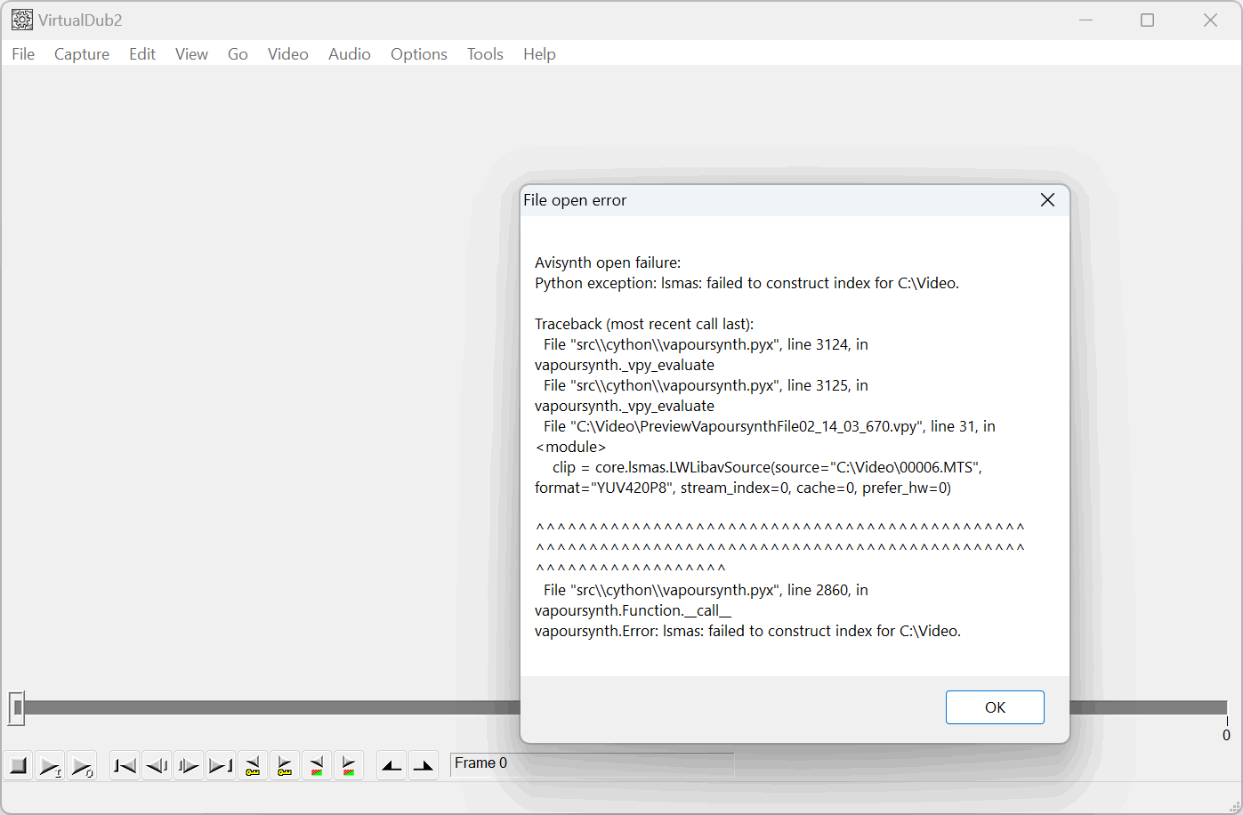

had another loading issue, but traced that back to forward/backwards slash in filename....
ie i was copying path on windows, or in total commander back to .vpy script which didn't open....peculiar thing is that comments section uses windows convention, while vapour seems to use linux format ie forward slash in filename

Hybrid always converts backslashes to slashes since Windows (like all other OSs) does support using slashes in file paths. Wink
(in the comments Hybrid uses whatever is native to the OS)
