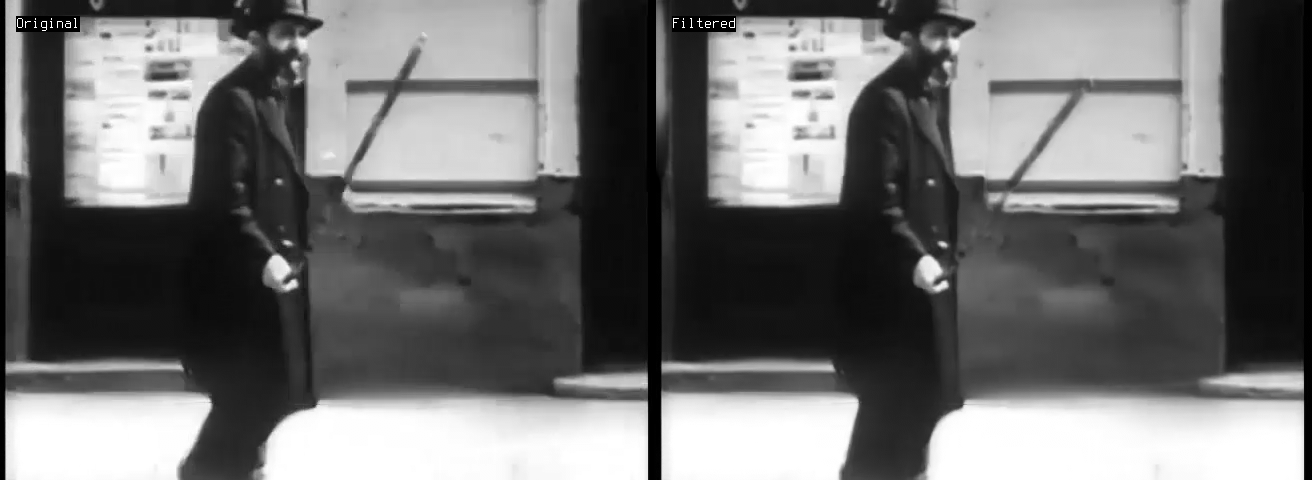

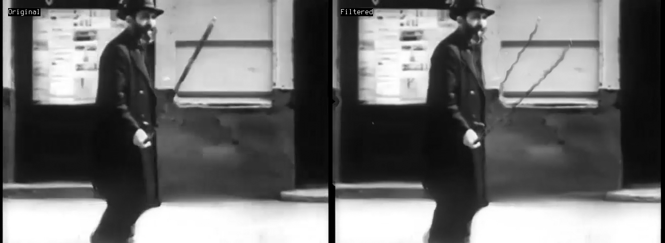

Thank you for looking into it. I can't seem to get it to work.  I have attached a better example to test.
Frame 17 is a duplicate of 16.  In method MV, you can see its interpolation of the cane, also in SVP; Threshold 0.3.  But RIFE just duplicates the Frame.
I've run RIFE factor 2 just to see what it would look like, which is now Frame 35 and its much nicer.
#25
Threshold 0.3 is way too high,..
a. try for example 0.004
b. add some deblocking&co (maybe artifacts removal) before using filldrops
17 looks fine when using rife and filldrops (like your rife x2 interpolation)
#26
Fantastic, it is working great.  It was the Threshold as you have mentioned.    Were you able to repair ReplaceSingle, that one is giving errors on preview on all methods.
