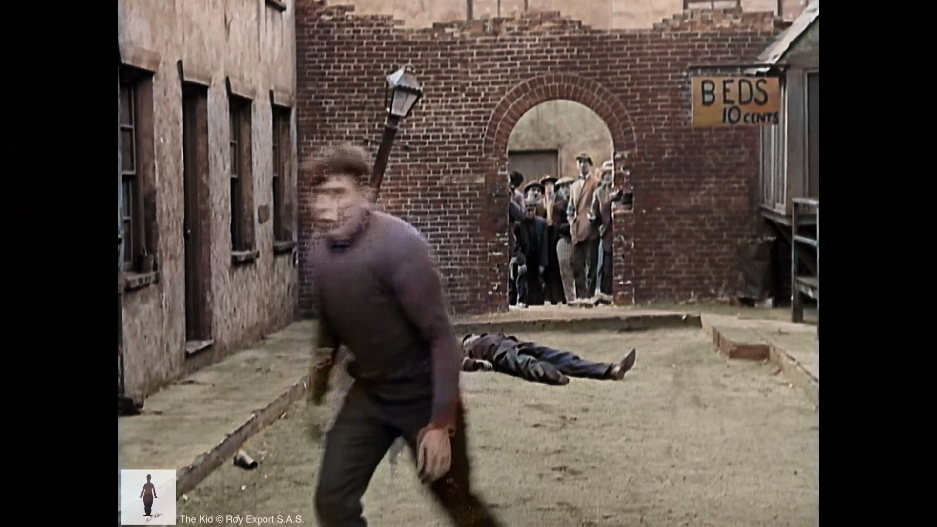

I have observed that on fast motion clips, on some settings the image looks distorted.
Here is an example:
Charlie Chaplin - The Kid - Fight Scene
Attached are frames 6883 and 6900 along with their counterparts with the distortions.
Using speed fast, Video+Artistic, Simple and Vivid:  Image looks normal
The distortion happens when I add this
Denoise is enabled with Color tweaks retinex/red (other color tweaks are fine)
or
Stabilize Temp is enabled, any settings
or
Exemplar Models enabled/HAVC or Deep_exemplar/ColorMNet any Ref merge including "no"
Is this the normal limitation of these settings for fast moving objects?

I performed some tests, but I was unable to reproduce your problem.
I attached the results with the scripts used to obtain the reference pictures.

Unfortunately I can't reproduce the problem using my development version.
What I get using this code:
clip = havc.HAVC_main(clip, Preset="fast", ColorModel="Video+Artistic", CombMethod="Simple", VideoTune="vivid", ColorTemp="medium", ColorFix="violet/red", FrameInterp=0, ColorMap="none", ColorTune="medium", BlackWhiteTune="none", EnableDeepEx=False, enable_fp16=True)
Is this picture
[Image: attachment.php?aid=3448]
I attached my development version 5.6.5 RC1, try it to see if the problem is still present.
