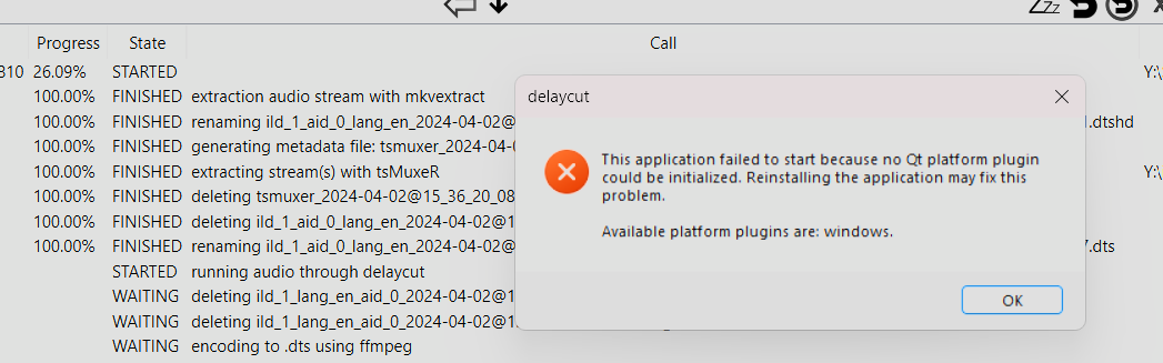

Hello,
I'm encountering a delaycut error since updating to 2024.03.26.1.
I've tried resetting to defaults after the update but unfortunately still getting the error with the delaycut setting enabled.
I've reverted back to 2024.01.12.1 for testing and it functions normally.
Debug log and image of the error is attached.
Thanks
Copying Qt6Widgets.dll Qt6Gui.dll Qt6Core.dll from Hybrid/64bit/Vapoursynth to also Hybrid/64bit should fix the delaycut problem.

I also was getting the same error with the last versions released by Selur (excluding the lastest dev)
[Image: attachment.php?aid=2357]

Yeah, I had the error popup on first startup after installing, probably a component check or similar.
I'd guess that error may not be effecting you if you don't have delaycut enabled (misc section of audio processing tab) which is off at default.
