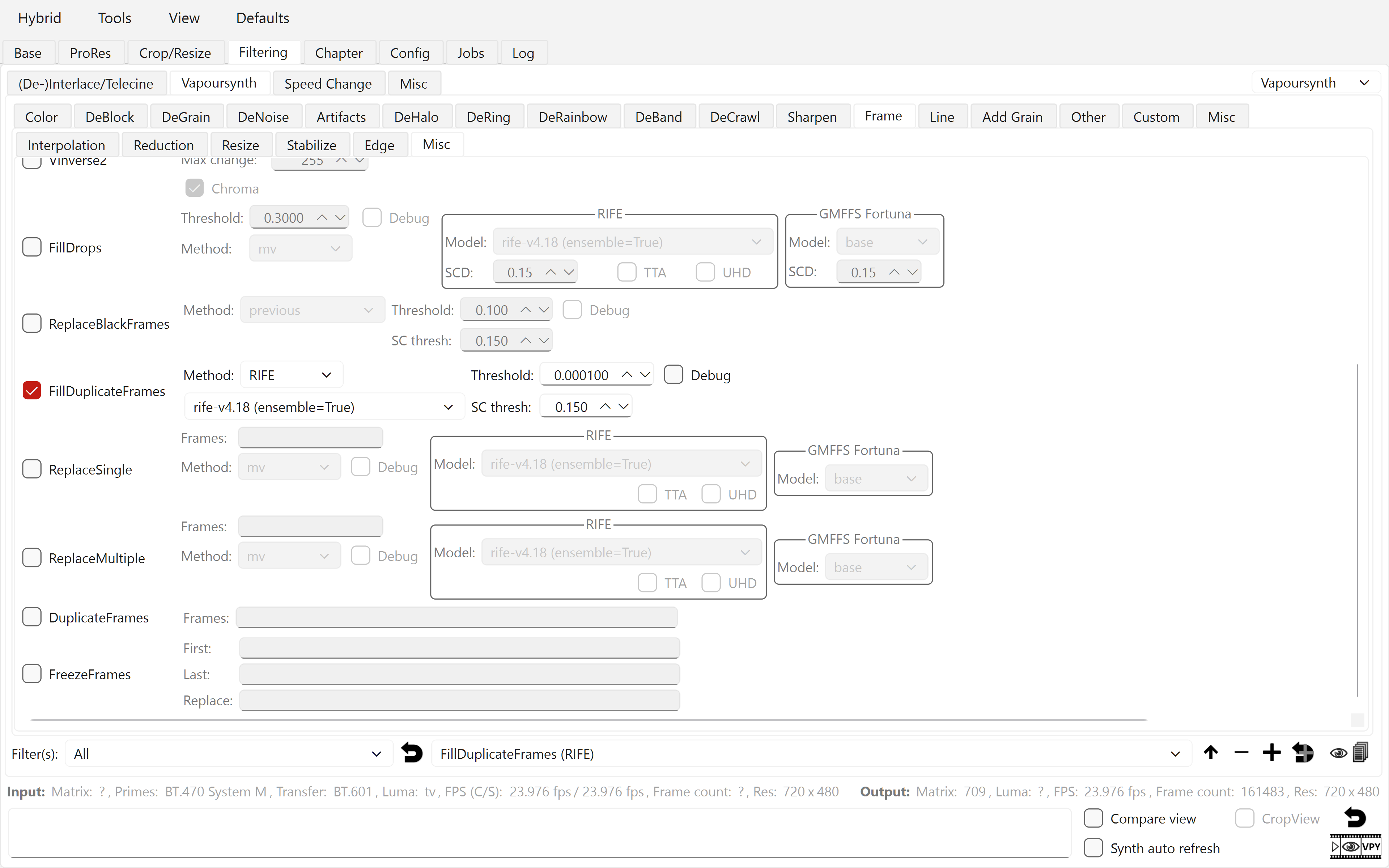

"Filtering->Vapoursynth->Frame->Misc->FillDuplicateFrames" is probably the right choice if there are multiple duplicate frames in a row sometimes, otherwise FillDrops should work too. Replacing frames with interpolated frames should not change av sync.

FillDuplicateFrames didn't work (with default setting), so now trying FillDrops.
Make sure to adjust the threshold (enable 'Debug' to see what the differences are), otherwise none of those functions will work as expected.
FillDrops (MV) doesn't work either, it simply creates a new blended frame of both duped frames.
I guess I will need to play around with the FillDuplicateFrames option, but I have no idea what setting to use?
a. adjust the threshold so that only duplicates get interpolated
b. select rife for the interpolation
if you send me a sample of your source I can sugges a threshold if that helps,..
