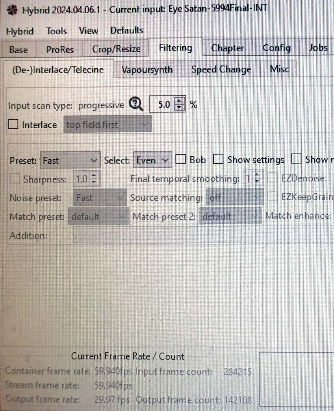

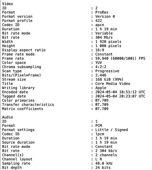

When I import my 59.94 (bobbed) footage and select interlaced out, the filter option says it is now 29.97, yet when I check the exported file in Media Info it is still 59.94 progressive. Any suggestions?

The only filter I set was the encoder to interlaced output (under the ProRes 422 setting). As I said, the filter settings said 29.97 but I got a 59.94 file, same as the input version.

The project is from a 59.94 Final Cut project, so the frame rate should be constant.
