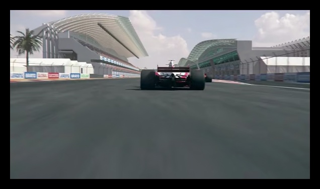

Is there a min resolution for ProPainters input?
Using vclip.avi as source (320x288) and the attached mask, I get a broken output.
(I first thought that it was some interference issue with BasicVSR++, but I get basically the same output when not using it.)

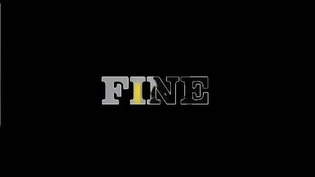

#83
Unfortunately ProPainter in this case cannot remove the mask.
The output represent the frame when the inference fails to converge.
It works for the attached video (same video but with a small logo on the bottom right corner).

#84
Ah, okay, so from the look of it the mask/image resolution must at least have a width of 512 pixels.
Resizing the video to 512x420 and then applying a resized mask works fine. Smile

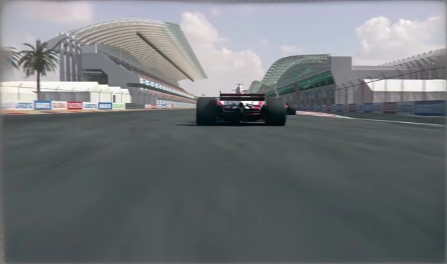

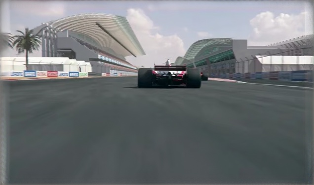

#85
It works even with your original avi clip.
The problem was your mask that was not of the same size.
Using the correct mask you get this result:
[Image: attachment.php?aid=2582]
Try the attached mask and should work also on your side.
