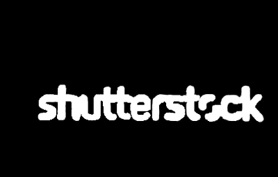

Ps.: did a small test with a non-transparent logo (see attachment)
.zip   logo_removal_test_1.zip (Size: 1,75 MB / Downloads: 217)
.zip   logo_removal_test_1_result.zip (Size: 834,38 KB / Downloads: 197)
