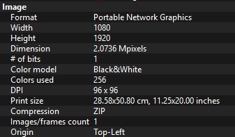

The true problem is that the format of your mask has #bits=1
[Image: attachment.php?aid=3539]
This format is not properly managed by ProPainter (It fails to recognize the mask)

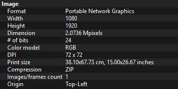

While the format used by mask_big.png is the correct one
[Image: attachment.php?aid=3540]
In any case I decided to ad another option in ProPainter called mask_enhance, that if is enabled (default) will improve the Mask's hedges to allow better Mask recognition.
I attached the RC1 of new ProPainter v1.2.4.
Let me know if it works on your side.
