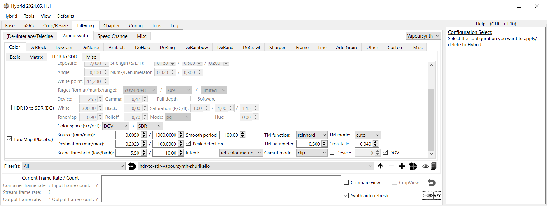

When encoding DoVi to SDR using Vapoursynth, I ran into the following problem: in some cases, the algorithm highlights some scenes in the video too much (in preview mode, numerous flickering frames are visible in the direction of increasing brightness a ~1 second before this scene). No matter what settings I adjusted, I couldn't turn off this flickering and floating brightness and force/fix it on some specific scale.
My settings in attach.

This is the first thing I tried. None of the settings change the behavior and the encoding algorithm DoVi to SDR.

Okay, I would have increased the 'smooth period' not lowered it to 0.
With 0 I would expect such flickering to occur.
As an 'ugly workaround' one could try whether adding Frame->Stabilize->ReduceFlicker or SmallDeflicker helps.
I just did it all. Smooth Period (1000, 10000), all kinds of settings with ReduceFlicker and SmallDeflicker - no changes, at all, the algorithm continues to turn up the brightness on already bright scenes.
