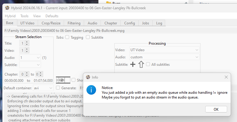

I'm trying to apply QTGMC to an MPEG 2 file and then export to UT AVI with PCM audio. For the audio, a have chosen Custom from the droplist. I've then set up the audio tab for PCM export OK, I think.
When I add to the job queue, I get the attached message, which doesn't make sense to me because I have set Custom, and not Ignore.
Thanks for any pointers.
Sounds like you configured the audio tab, but you did not add an entry to the audio queue, which is why the notice appears.
Thanks Selur, that fixed it.  Smile
