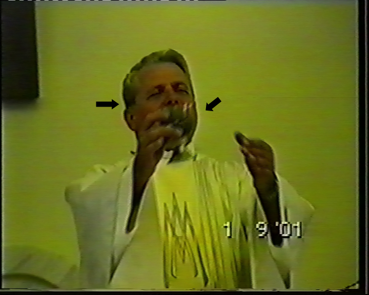

maybe because everything is a lot yellow... but i tried with dehalo without any success..
and this is the portion of clip:
www.wcn.it/halo.avi
thnak you in advance for any suggestion

Hmm,..
chroma is shifted, saturation is way too high,... (to fix the colors some custom LUT is probably needed)
Using VSGANFilter with
https://openmodeldb.info/models/1x-Dehalo-v1-Compact helps somewhat,...
Note a finished thing, but it might help to get started:
script:
https://pastebin.com/V6eRt4ex
images:
https://imgsli.com/MjgwNjI5
(adding ReduceFilter will help with the luma flickering)
I suspect that using LGhost might work, but I always struggle with that one.
(folks over at videohelp, probably can suggest something other than VSGAN for the halos, since they more often work on bad vhs captures&co)

As a side note: the problem is not the color, but more the thickness of the halo compared to the normal lines.
Posts: 13.222
Threads: 73
btw. adding additionall DeHalo_alpha and 2xYAHR also isn't bad:
https://pastebin.com/nJXE7Sae
