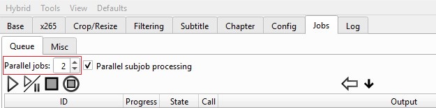

So, it is better to enable it ?
[Image: attachment.php?aid=3354]
#17
Angel
That's "Parallel Jobs' not 'Parallel subjob count' (which is under Jobs->Misc).
Per source, one job with xy sub jobs are created. (extract, convert, mux,...)
'Parallel Jobs' allows to process multiple jobs/sources in parallel.
'Parallel subjobs' allows during the processing ob a job to process multiple of its sub jobs in parallel.
